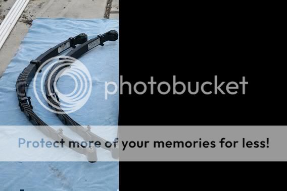

little update! just bought the Giant Motorsports 64" leafspring kit! pulls 21 iches of rear wheel travel with a 16" shock. now this just kicked me into high gear! lol
If you don't mind me asking, how much did that kit run?
from Giant i believe its about 1700 bucks but i got it for 1300. its not at all a cheap kit but for what ill be doin in the desert it will work awesome. compared to a three or four link (if i bought one, not built one) its really cheap as those are about 3 to 5 grand if not more.

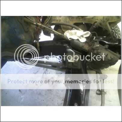

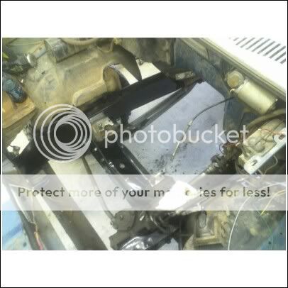

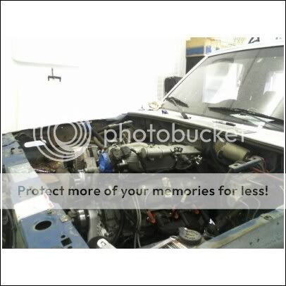

truck is comin along. finished plating the driver side framerail where the fuel, brake, and speedo cable are. painted it too for good measures. then ripped the old fuel lines out, put the flywheel and clutch on the motor and put the 2.8 motor mount brackets on the 4.0. Then i dropped her in the truck. from there i cut the old rad mounts out of the exploder and welded them in the ranger and mounted the rad and electric fan. put teh powersteering pump in and hooked it up to the gear box, put the belt on and pulled the wiring harness out of the exploder. boy do i have my work cut out for me there. PICS!

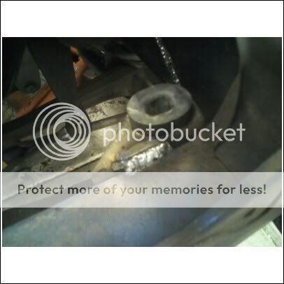

just finished weldin and paintin

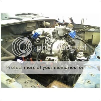

motor is in!

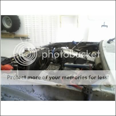

new rad mounts and rad mounted with fan (fan is only temp for now till i get a bigger one)

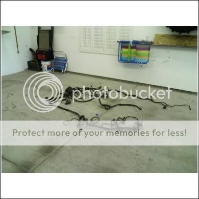

and my new mess lol. anyone have any tips on this wiring, looks like 3/4 of it is jsut interior and light wiring.
Ehh yes and no on that, IMO most of the wiring that goes through the firewall is A-going to the computer or B-going to the fuse panel and or steering column. I know you probably hear this alot but take your time. Don't "half ass" the wiring, make sure you have good connections at the plugs, install all the grounds in the correct place, etc. I know i screwed my harness up when i did the cab swap on my 87 and i really payed for it.
yeah i will definitely be takin my time. from what i can gather right how none of the engine control wires run to the steering colum/fuse panel. Im gunna disconnect each wire where they either clip in the computer or fuse block, not cut wires unless to splice.

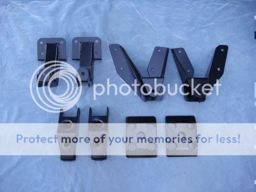

wow man nice build, looks like your going to be the guy that buys the stuff that i gock at on giantmotorsports.com haha. im guessing the deaver kit came with instruction but this page has a pretty good step by step guide. one of my friends who works at an offroad shop says that those shackle mounts tend to bend if you romp your truck hard, so i would keep at eye on them. goodluck on the build
http://www.desertrides.com/reference/giant_64.php
thank you! not too sure what you mean by gock but im guessin stock?? aas for the instructions, the ones of desertrides were the one i was gunna use. i am a member there also. i will definitley reenforce the shackel mount then and fully box it to keep it from flexin as racing this thing will be more than just rompin it hard lol
