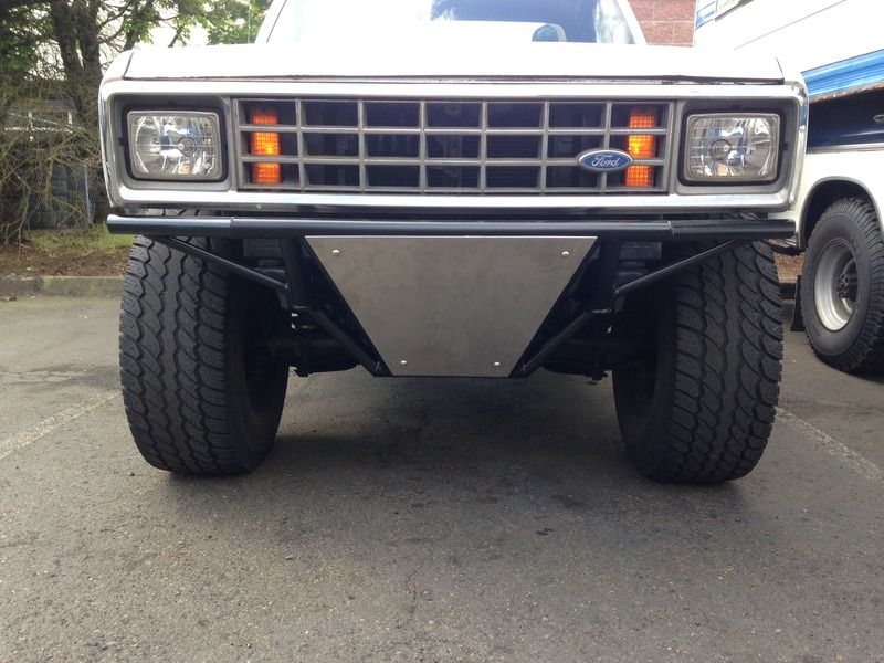

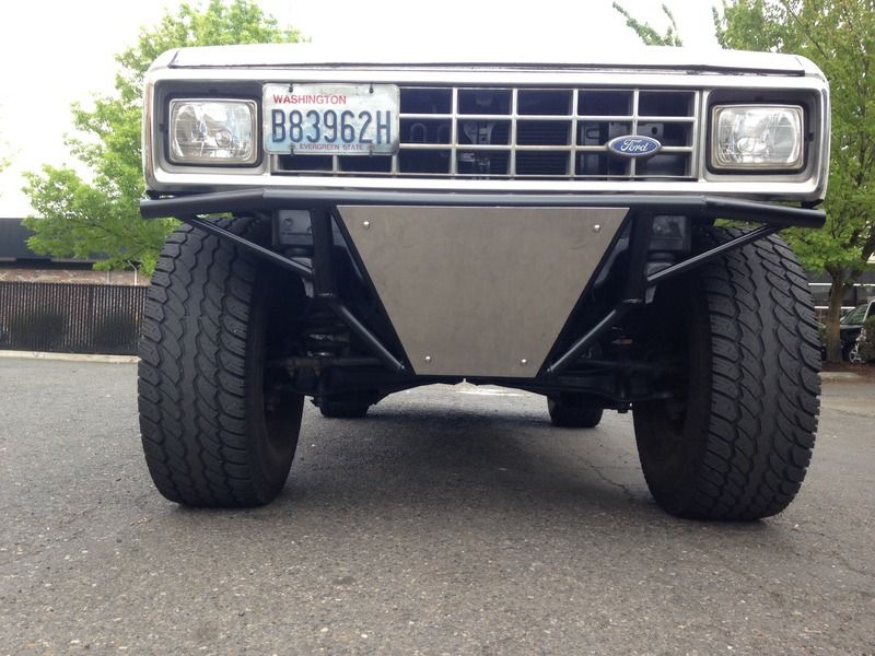

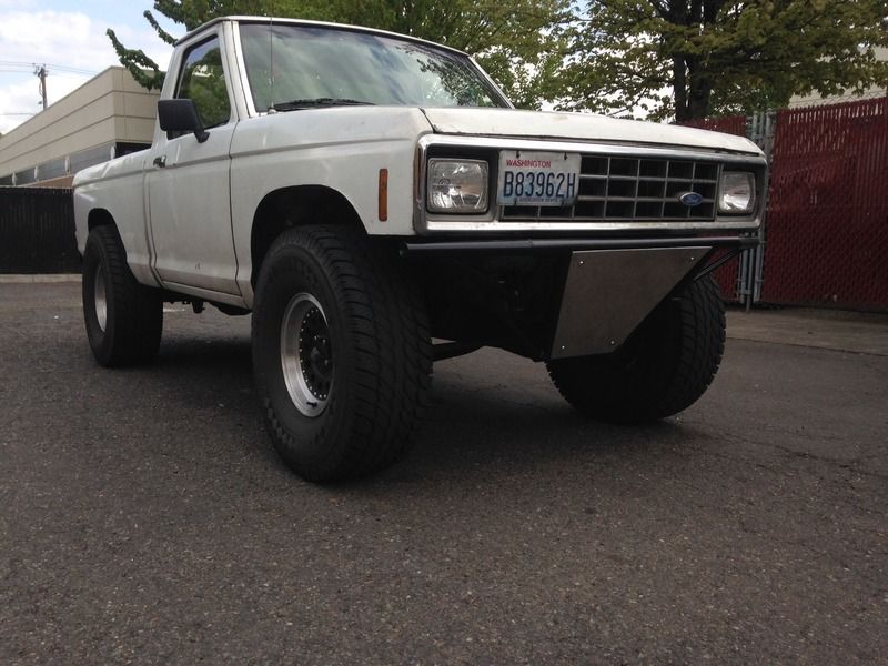

My first bumper build ever.
1.75 & 1.00 .120 wall CREW
Skid plate is 1/8" 5052 aluminum
Miter cuts because I don't have a bender
Very functional to say the least
Relocated the turn signals by mounting them to the core support and behind the grill.
I also mounted the lic. plate on the skid
The bumper came out very nice!! I like it. The only thing I would do is put end caps on it. Just to keep out crap from getting in there...or some jerk weed from stuffing a fire cracker in there...lol. Good idea on the turn signal relocation. A+, Bro!!!

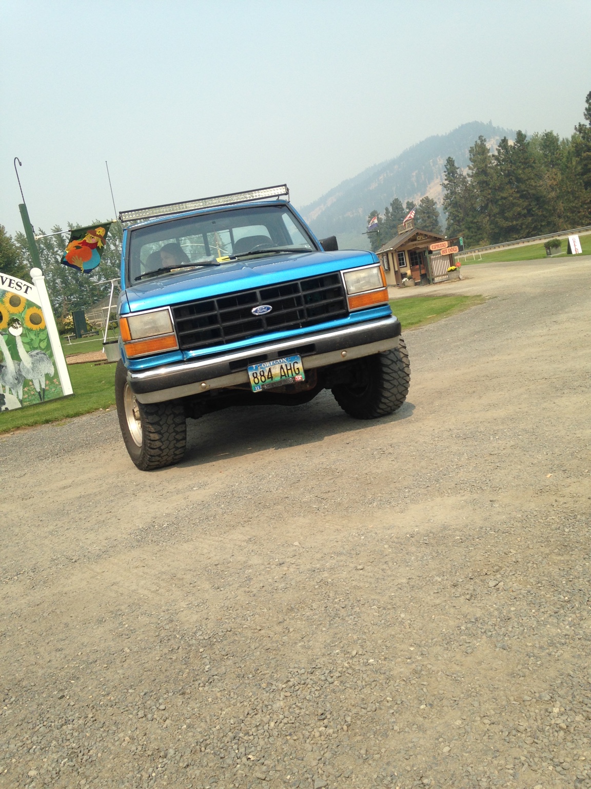

This looks so clean, I've been looking for something to fit on the front of my 92 ranger!! I can't seem to get any ideas from sites, or anything, but this however looks really good. I might have to make a 2.0 version of this, with a front stinger :o
My truck for reference
