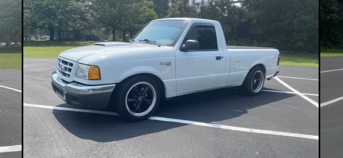

My Ranger is a 2wd & am running a spring under with explorer axle & leafs. No cutting or welding from what I can tell. It sat a little lower than I liked so I added a leaf & like how it sit now. No longer bottoms out against the frame. This was prior to the add a leaf. I gained about 1.5 on the rear.
Thanks for replying. 2wd coil spring (?) Is a slightly different swap, and you are almost definitely lower that I'll ever be. That said I have all the same parts you mentioned already stashed away. Explorer axle and leafs. No add-a-leaf, but extra Ranger and Explorer spring packs. Longer and shorter shackles. I'm prepared to play with it, but what I end up using will depend on how low I can go with the torsion bar 4wd front. Like @lil_Blue_Ford, I'm going to need upper arms to do much and it looks like that is a custom deal for this setup.
Until I can get the upper arms, I may just run Ranger leafs without the lift block and turn the torsion bars down to match. AKA, stock 2wd height.
FWIW I've also got an '85 2wd, a spare Explorer axle, front brake upgrade, and drop beams. What ever components I don't use for lowering the '99 will likely be used when I get to building it. That one is probably staying 4 cylinder, but might get a turbo build. That's for another, future thread though.
