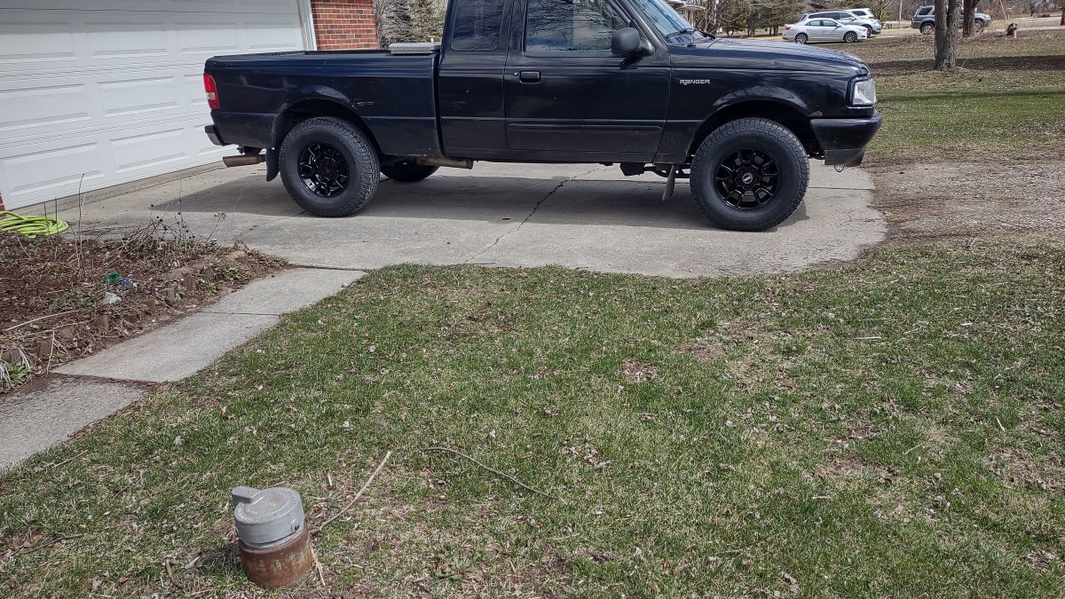

Preparing for 5.0 swap, what issues am I likely to encounter?

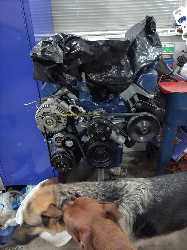

Yeah I'm a little curious too. Eventually I'm going to pull the 5.0 so I can fix a few things. Sell me on the idea and I might start collecting the pieces.

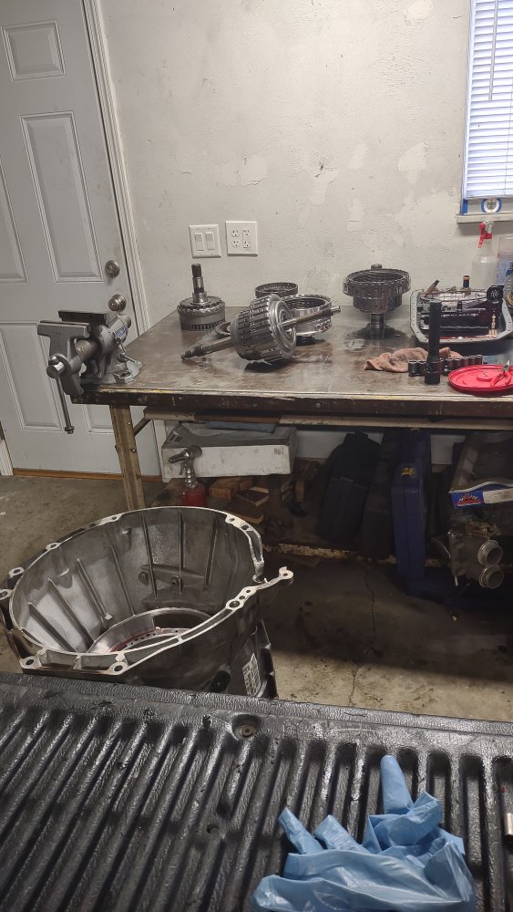

For what it's worth, my 1st 4R, it lived past 100k before the OD band said enough is enough. The sealing rings at the back of the case has worn in. I bought another 4R, went through it, months later it started applying the OD band in 3rd. Long story short.
At this point the 6R was bought for $450 with 110k miles, only thing done to it is going to sonnax bushings few are known to wear replaced them all. I have 45k on the build now and looking back. I wish I would have gone to the 6R sooner. Makes the 165 AFR heads, comp cam( if memory serves correctly it's a efi grind comparable to a E cam) short tubes explorer intake, 2¼" Y into 2½" single. Set up for the engine is nothing crazy. But adding the 6R to the mix made that 3" stroke engine much livelier. Using a BW 4417 from the f150 the factory shift controls handle the tcase motor just fine. Using Duff mounts and urethane ranger trans mount. Truck averages 15.5 to 20.5mpg and needs tuned still running 24 lb injectors on a stock explorer EEC.

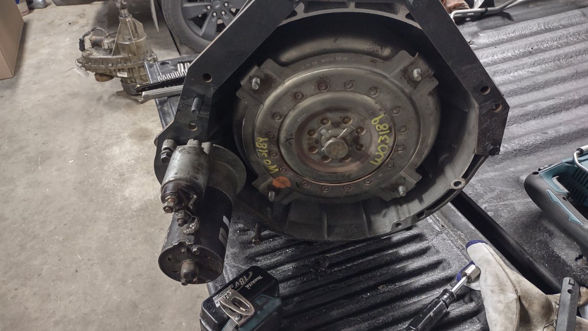

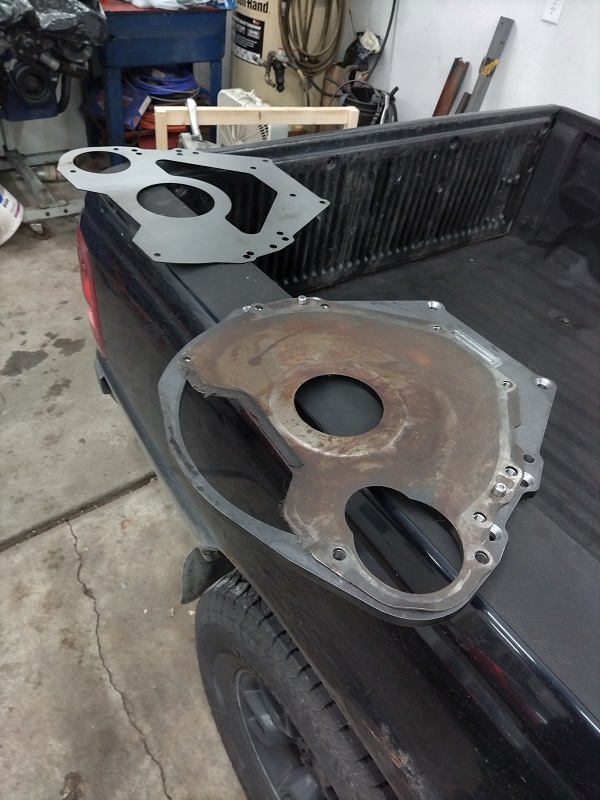

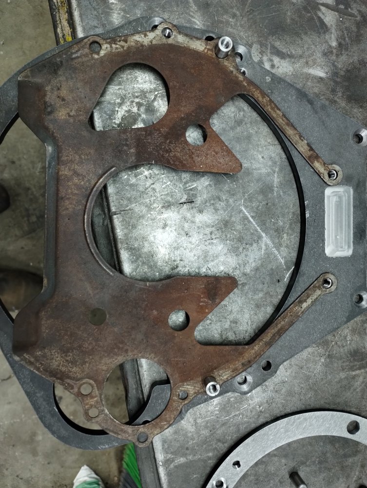

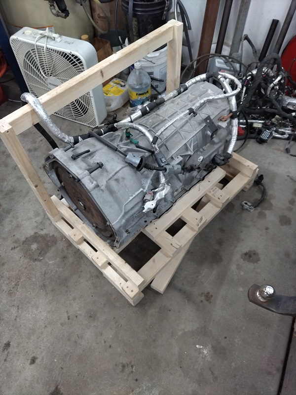

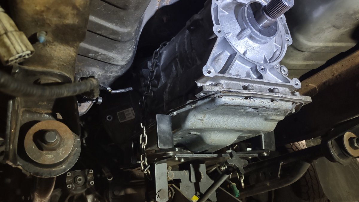

What did you use for an adapter between the 6R and the V8?
Thanks Curt.
He told me he will put some more in when he gets some time.

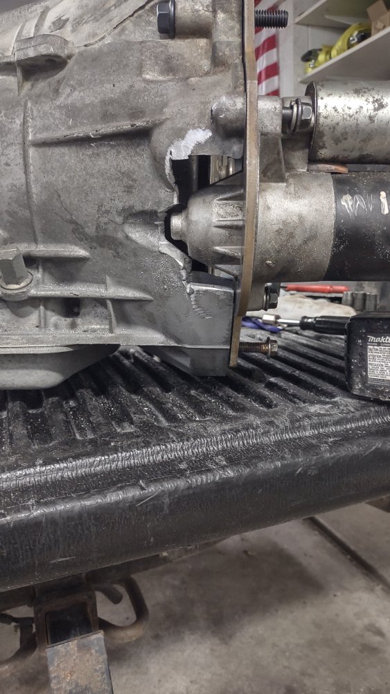

The adapter used was an earlier version and a plate.
Just like the picture shows you had to cut the starter pocket.
There are other potential options now.
Nipping the block at the starter pocket can allow for 5 bolt retention and it's free to do. And should allow use of the 3 bolt starter.
Not deep enough into it yet for the actual issues pro and con.
I'm not saying to stop talking about it here, but this transmission swap sounds like something that really needs it's own dedicated thread to discuss and hash everything out in. Be a good start for a tech article once it gets worked out. I understand that y'all may want to wait until things are more ironed out though.
You can see the adapter there, I bought it from a guy named Ryan Denney, if you look up 6r80 to 302 on you tube you will find him. ¼ plate. The 3 bell housing bolts the modular doesn't use I used countersunk bolts on. The dowel pins get knocked out and tapped the hole past the machined surface. For the 10R140 I went a little different route. The pictured dowel is the same.500 as the pushrod dowel, larger is the same as the modular, drilled and tapped to 7/16-14, they will get welded in the adapter.
The other option I have been told about is cutting the bottom passenger side ear of the block below the dowel pin, that will give enough room to run the modular starter, no spacer, just did something similar with the dowel pins they just tapped the block side dowel and ran a bolt in from the front to secure it in the block.

6R is of interest to me too, just a long ways off.
Project right now is to get the truck running, drivable, and reliable as possible with the V8 swap before summer. I'd like to be driving it to LBL for the meet in September if I get to make it. I need to put some miles on it before then and I know it's going to be too hot around here to be fixing stuff during summer.
After that my focus will be back to the F-100 for a little while to get some stuff done and "stabalize" the rust issues. While all of this is going on I'll be scheming on how to clear property to build a shop, and hopefully have a shop in the next year or two.
Once shop is built I'll be starting on two or three engine builds. A nice SBF for this, either a nice FE or a 7.3 (stock godzilla) swap for the F-100, and a 2.3 turbo for an 85 Ranger. Not sure which one will come first, be needed first, or be finished first.
It's not a discussion I really want to get into much right now because it's way off from the current goals, but to go with the new SBF for this I've been scheming on building a stout 4R and possibly how to incorporate paddle shifters. I know that the transmission is capable of being controlled that way, but the easiest ways to do it are to use something like the US Shift controller or go full aftermarket EFI with a Terminator X Max. Using a 6R (or maybe 10R?) paired with one of those two options is not out of the question, but it is something I'm not ready to explore at this time.
