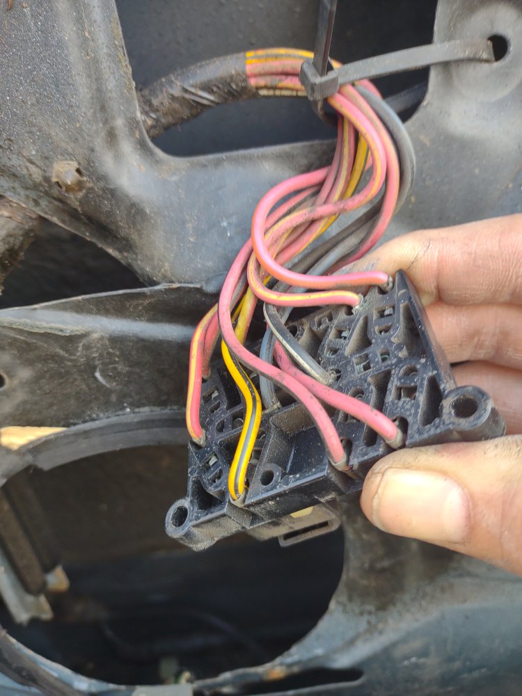

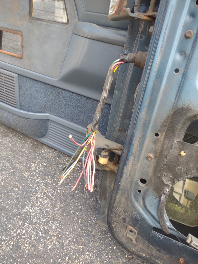

These doors came off a 89 bronco ii I haven't installed in my 87 bronco ii yet. so I need to cut and splice something together to see if either door power options work
Knowing this bit of info what do u recommend now?

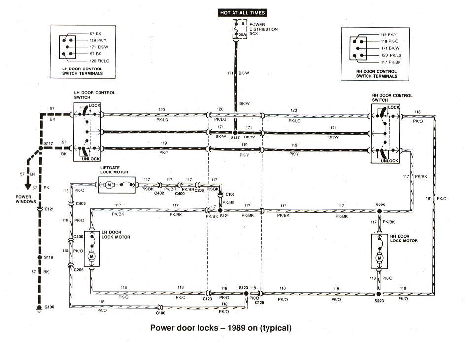

Ground is blk /white strip correct? Only black 1 on here
I grounded the yel/blk and red/blk and powered the lt blu black and window goes up and down. Now which wires powers the door locks
