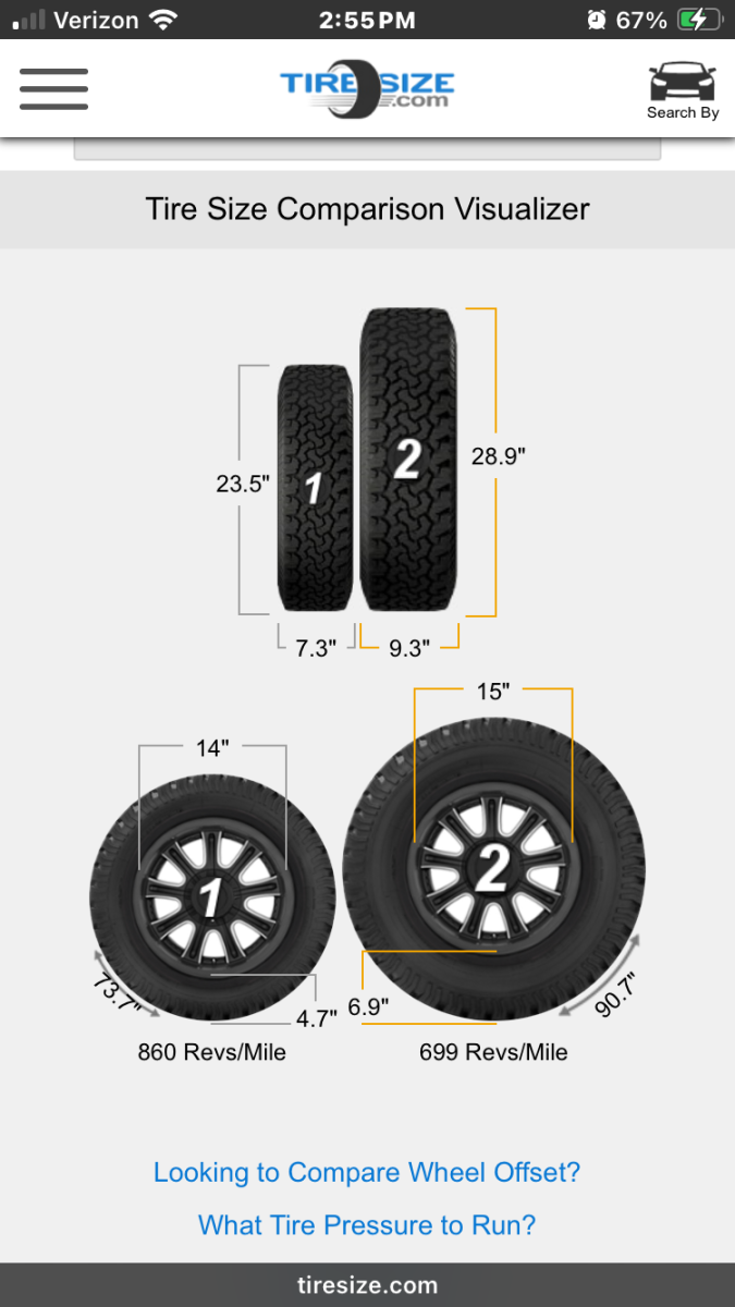

Having said all of that, I had a completely different thought. I have 235/75/15s on both trucks now. The 97 4.0 works perfect perfectly for this kind of stuff. The 87 seems a little underpowered when I climb a long hill even empty. If I downshift, it’s fine. But if I’m pulling a load, I would prefer to downshift as little as possible.
I have a pile of wheels out next to the shed of miracles, and I have a bunch of 185/65/14 tires on bullet hole wheels. Bullet holes would be my preference for a project like this. If I simply swap those two wheels/tires, it goes from 699 revs to 860 a mile. Wouldn’t that accomplish the same thing as putting in taller gears?
I’m not sure if I’m a fan of the appearance of smaller wheels and tires, but so much behind the doors will be custom, it’s just a matter of making it look right.
so, forget the best way to get it done, what’s the cheapest way without actual chickens running in a wheel on the roof?
Shorter tires is almost exactly the same as higher ratio gears. Gotta be careful of going too narrow on a regular pickup or it can get tippy. IDK how that would play into your project. Probably non-issue. Definitely the cheapest way to go.

There is a calculator on site that would give you the info to figure out how tire size changes gear ratio effect.
Wheel-size.com. I used it every day when I was working on all these things a few years ago.
I wouldn’t use a tire as skinny as I illustrated, I just have a bunch of them laying around on Ranger rims, so it would be an easy way to check how the truck would perform.
edit, correction: I might use those little tires on the trailer, but not on the steering or drive to tires of the truck
I don't know why you wouldn't? Its not like you're hauling a ton of mass. As a rule of thumb, the tire pressure being the same, both those tires have the same pounds per square inch transferring load to the ground.
