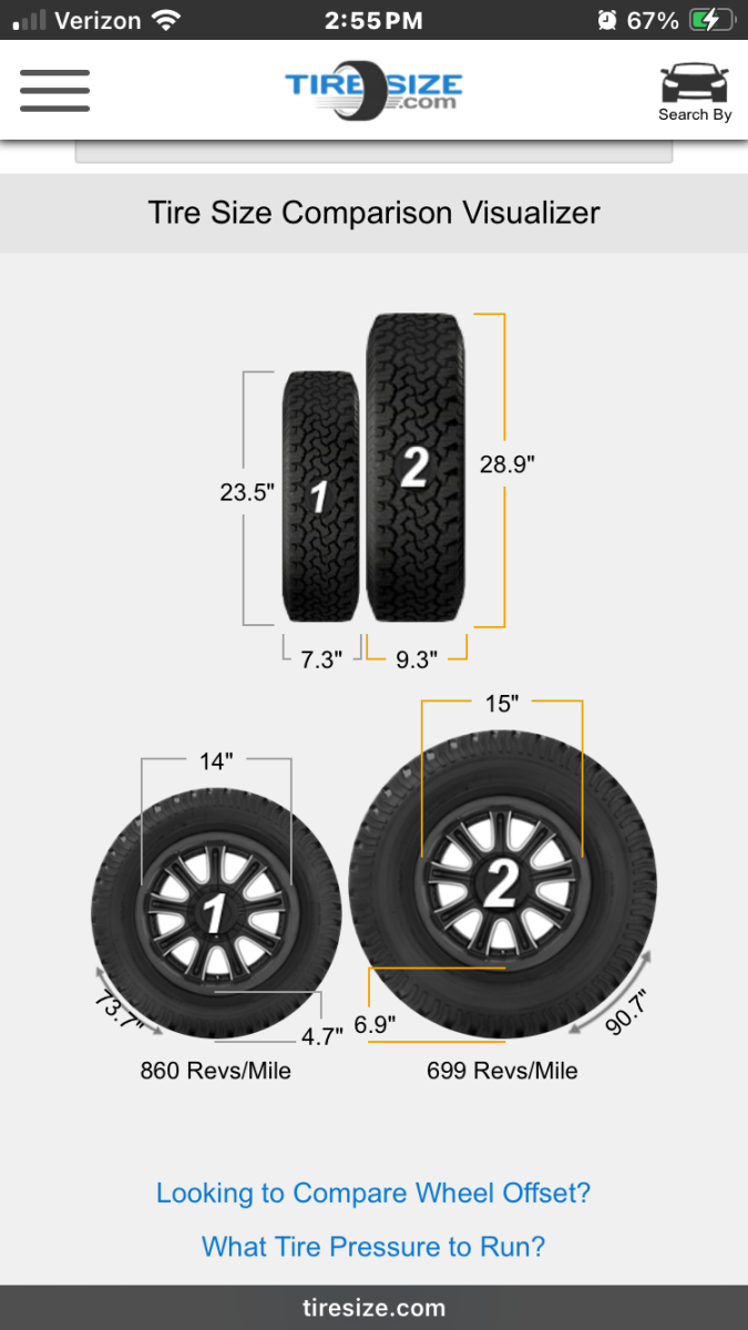

I have a pile of wheels out next to the shed of miracles, and I have a bunch of 185/65/14 tires on bullet hole wheels. Bullet holes would be my preference for a project like this. If I simply swap those two wheels/tires, it goes from 699 revs to 860 a mile. Wouldn’t that accomplish the same thing as putting in taller gears?

Then 4.10:1 might be a better choice for you for that build. You'll either even out on the mileage that the truck is getting with 3.45:1 or maybe a little less.
As far as the '87, have you looked at smaller 15" tires used on the Rangers in the past? 225/70R15 is common on RWD Rangers and might be a big enough drop in radius to get where you want. Effectively bumping up the gear ratio a bit. Perhaps 215's might get you there as well. Both are going to open up the gap between the tire and the wheel well, if that is something that matters to you.
