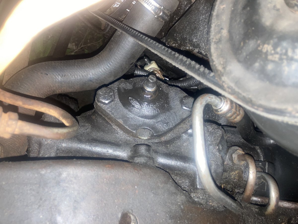

Two, the top adjustable nut thing on the steering gear box looks like it may be leaking. I believe these two leaks are dripping down and getting onto two different sections of the suspension/frame. But it's tough to confirm this.
I did a pretty thorough wipe down of all the built up fluid that has been coating everything in this section of the truck, and waited a few hours and took a look. Below is a pic of the top of the steering gear box and you can see the fresh fluid. That's after a few hours. Doesn't look like anything is dripping down onto it.

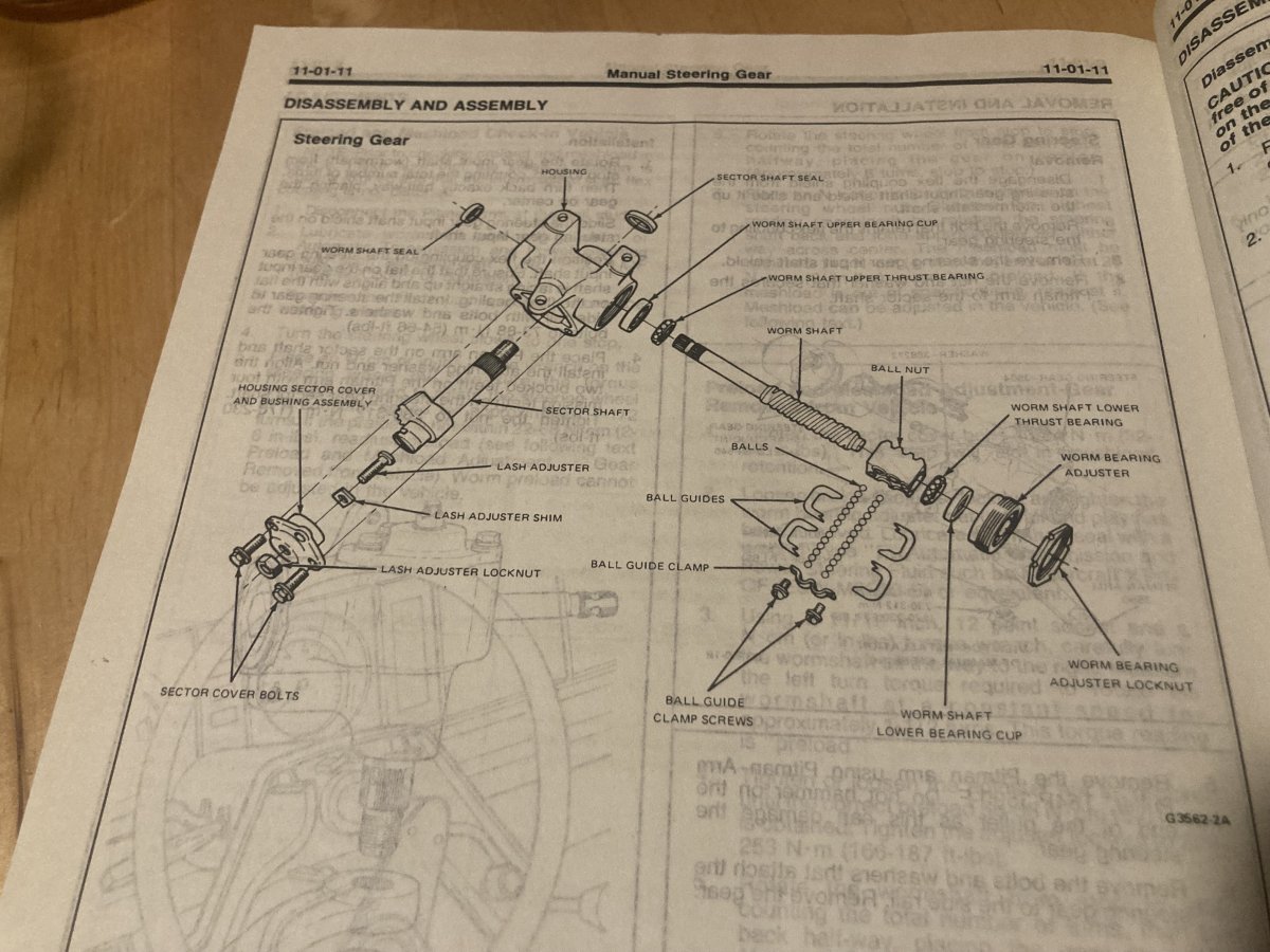

So the two questions are.. 1, regarding the pump.. if there are no leaks at the hose connections but there is fluid buildup behind the pulley, is it time to rebuild/replace the pump? and 2, regarding the steering gear box, it's tough to determine from diagrams in the Shop Manual what I should consider to replace, as in like orings/seals. Anybody know if this is a common symptom, and what's involved?
Attached pic of Shop Manual's steering gear page for good measure....
If everything is still working well, I'd say just replace the pump shaft seal. I did this once on mine, also once on a friend's truck. Not hard to do with the right tools (you'll need a puller for the pump pulley).
As for the steering box, is that nut tightened down all the way? (its been awhile since I had one apart, I can't recall if it just tightens metal-against-metal to seal it or if there's a O-ring in there)
P.S.,
You have open the page for the manual steering gear in your book (need to go to the section 'Power steering gear'... probably section 11-02C).
Ah, thank you! Yeah was definitely on wrong one.
As for the steering gear leak at the lock nut, I’m no longer sure it’s the issue. Im going to wipe it off again and lay a paper towel over it, and confirm that it’s a drip from above. If from above, it would be from the front of the pump, after running down one of the mount plates and over to above the steering gear and then dripping down. I’m hoping that’s what it is so that maybe this is just one leak situation not two.
I did put my large socket wrench to the steering gear lock nut and it didn’t budge in either direction with some solid effort. So at least I know it’s not loose. But I’m not going to mess with it and instead just confirm the above.
