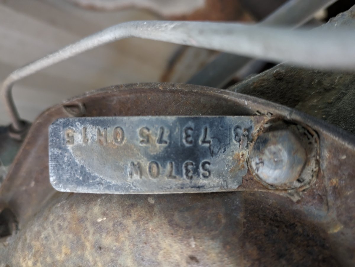

what gear ratio is in the differential? that is the easiest, fastest way to make a vehicle faster.
if you don't have a 4.10, and i don't know what came on the 4 cylinder trucks, get a 4.10 axle from the junkyard on an explorer or ranger with the 4.10s.
welcome to the group.
I don't know what ratio it is. It cruises around 2,100 to 2,200 rpm at 60mph.
look on the tag on the differential and you can also take a picture of hte sticker on the driver door, like where the latch is. look up the info in the tech section on here and it should tell you what the numbers mean.
but i always just climbed under the took a pic of the metal tag on the diff cover bolt. it will tell you the numbers. the shape of the diff cover tells you if its an 8.8 or 7.5 (i think is the smaller one)
check out the tech section though and it should help out.
