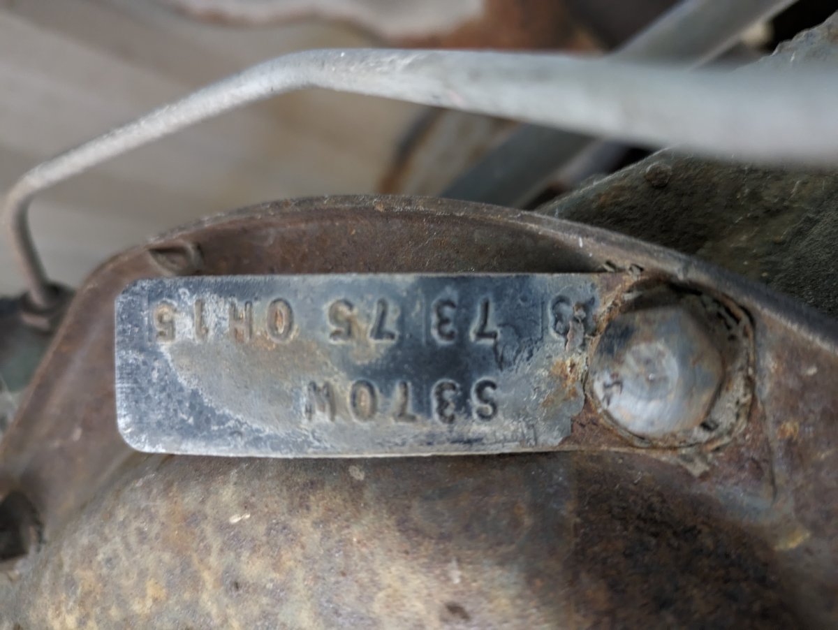

and hit your local junkyards to try and find that 4.10 rear end. my 04 came with a 4.10 and the 8.8 rear axle. i would be fine with a 7.5 because i don;t do anything but the 4.10 is so much fun. i have the 3.0, which is a little more hp than you have and it is a high rpm engine, just like yours. the 4.10 lets me get into the rpms quicker and stay there easier. it definitely makes my ranger a lot fun to drive. all i have done to this one is change the muffler. i still enjoy driving this truck every day
I think I will possibly do that. Do you swap the entire axle out, or just the differential?
