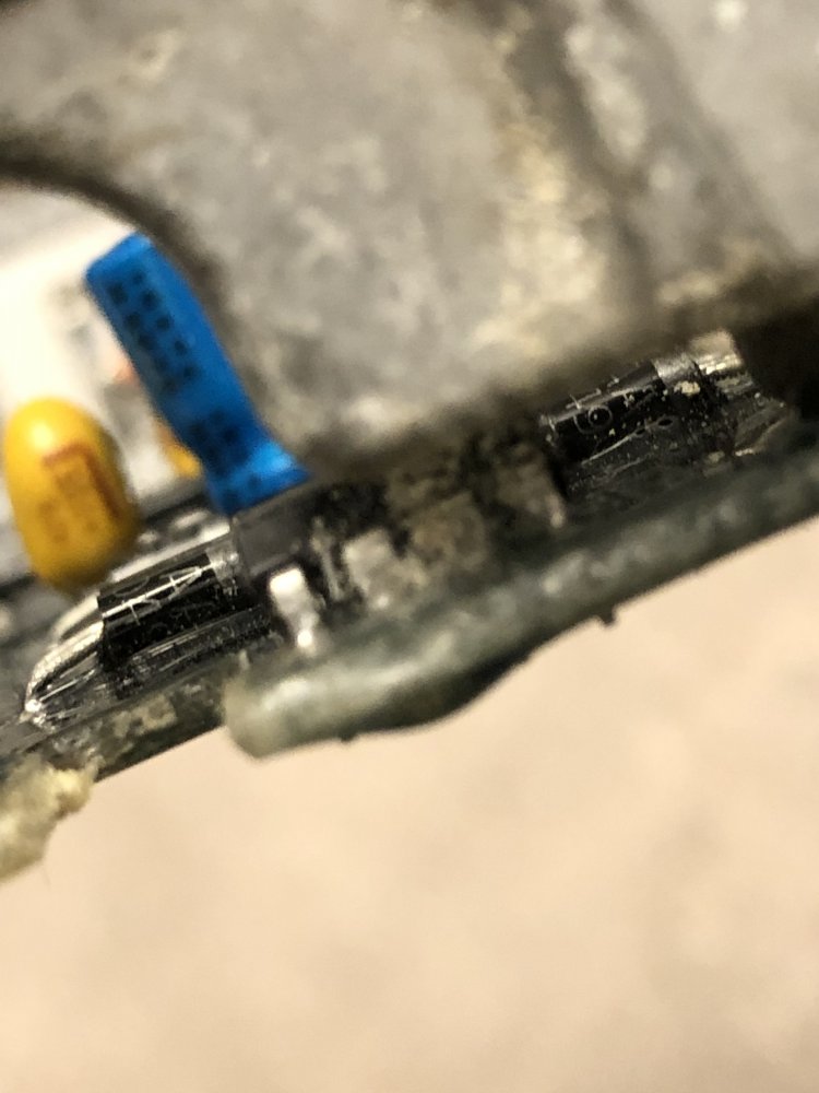

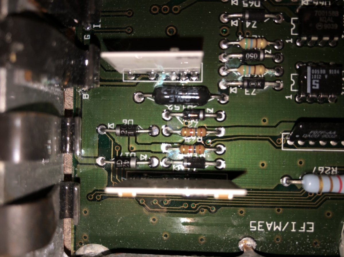

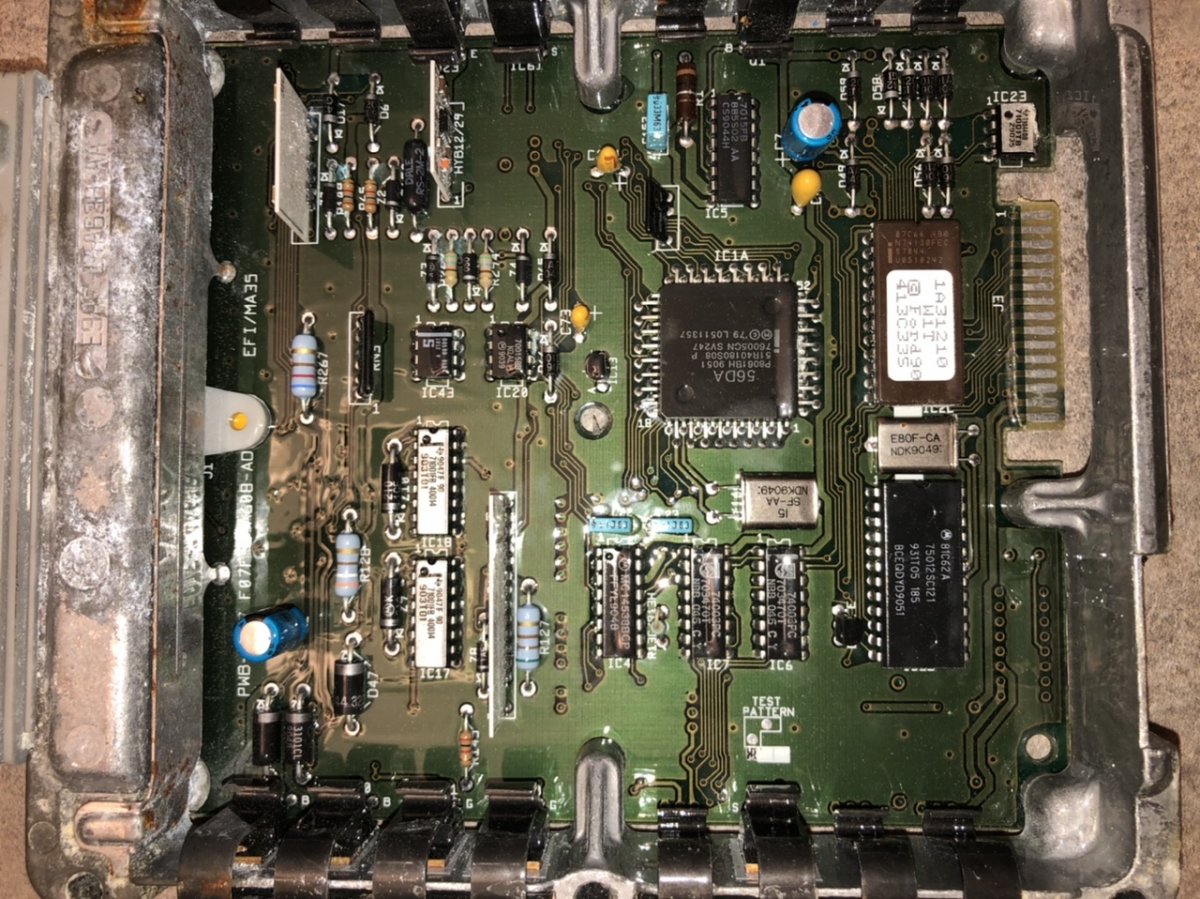

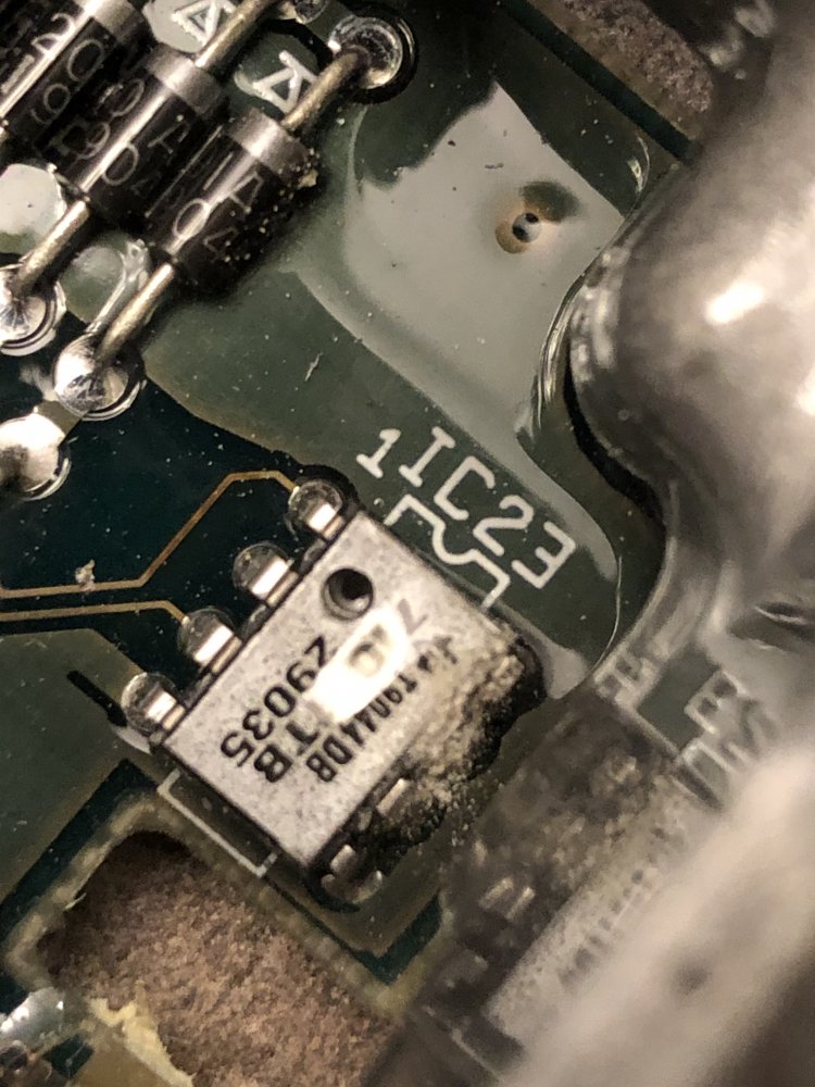

So I pulled the PCM. It’s EEC-IV and only seems to have 2 capacitors on it. They look in real good shape. There’s a couple questionable areas on the board I noticed though. Some green death on a couple resistors and a chipset. Also looks like some issues with the connection on IC23 maybe. I’ve attached photos the best I could. I’ll go ahead and clean up what I see and try it again. Unless you suggest I replace those caps anyways. ?
I would get some isopropyl alcohol and Q-tips and clean it up
There has been some moisture in there
If you can get the 2 new caps then I would replace them just because they are 25 years old

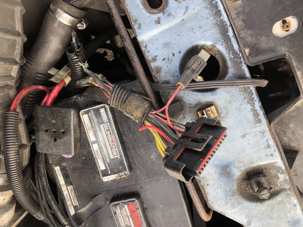

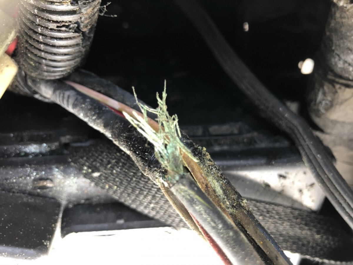

I found a black wire coming off the harness for the EDIS module was destroyed. Someone had done a real real poor splice and tape job on it in the past.
once I rewired she’s working great again! Thanks for your help Ron! I wouldn’t have known where to look without you.
