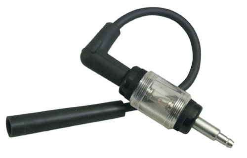

Have you actually -tested- for no spark? Just wanted to confirm. If you don't own one already, one of the tools you should have in your box is a basic spark tester like this.
On the side of the road, I tested for spark with bare metal and a screwdriver.I did this after spraying injector cleaner into the intake because I knew it would of fired just on that. I used one of those after I got it towed back home
