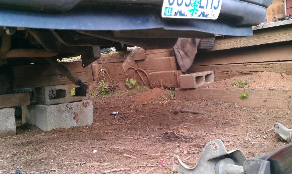

ttb lift out took around an hour or so.
front end cleaned out!!!

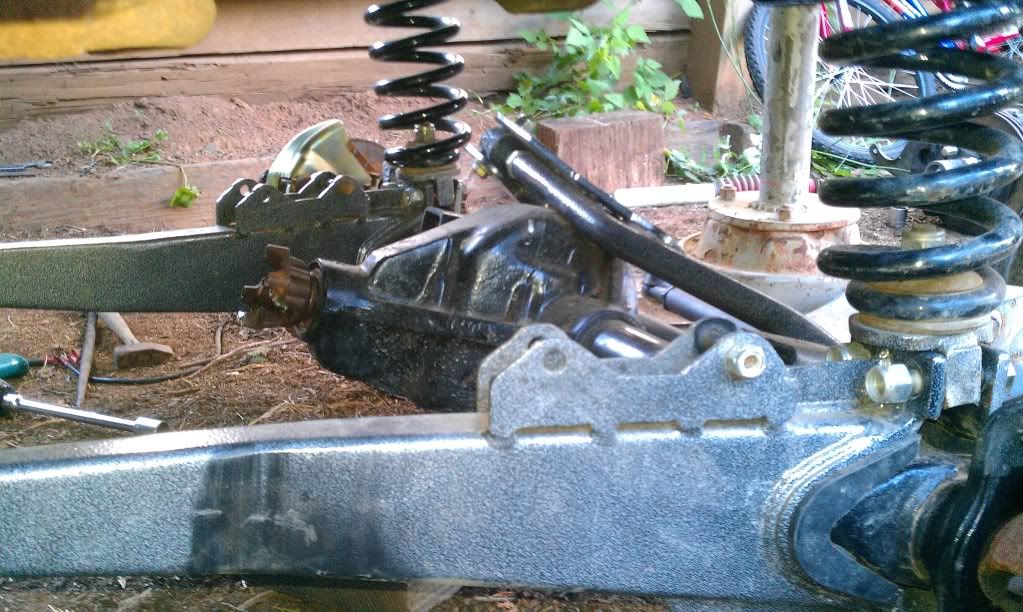

radius arm brackets...eh they'll work for the time being.
radius arms and the d44

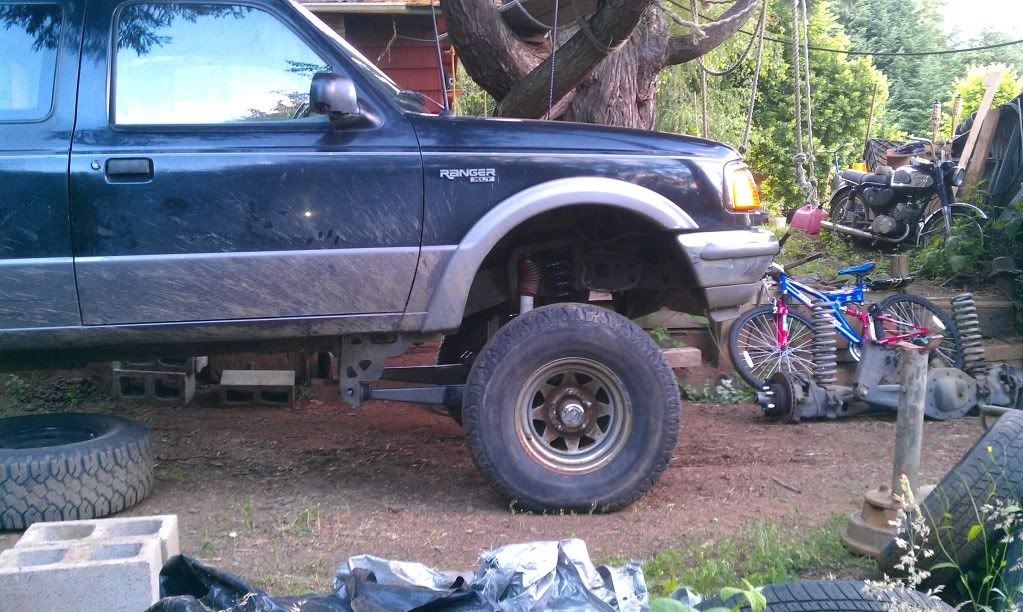

front end view sitting on its own weight
side view. dont worry about the tires, they are rollers.

Not bad for a bolt on. Looks like the tires/axle sits back furture then it should.
yeah from the looks of it in the picture it sure does huh, didnt even see that. ill check her out here shortly.
