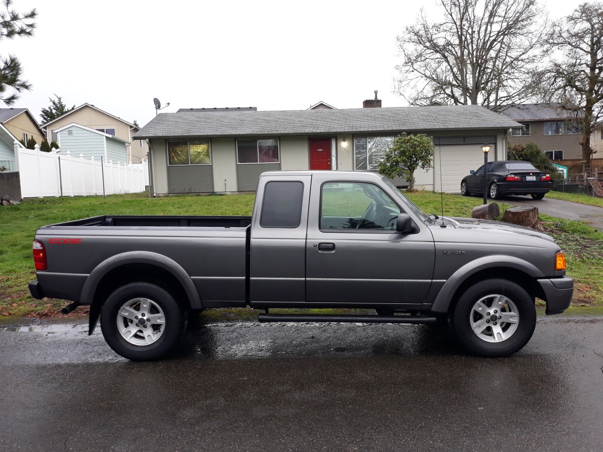

Subject; 2005 Ford Ranger Edge, 4.0, Manual, 4x4, no alarm, very good condition with 140k
Question; Unlock truck with key, get in truck, push in clutch pedal, check trans is in neutral, start truck, truck runs great....... turn on park lights (*#@%*!) horn, wipers and washer fluid kick in.
Hint; If you turn on light switch before you start truck nothing happens, if truck is running and you turn off lights and then turn them back on (*#@%!)
Answer; tired of chasing everything I can think of
