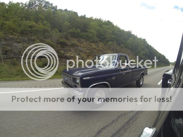

Few road shots from the drive out with 036speed
