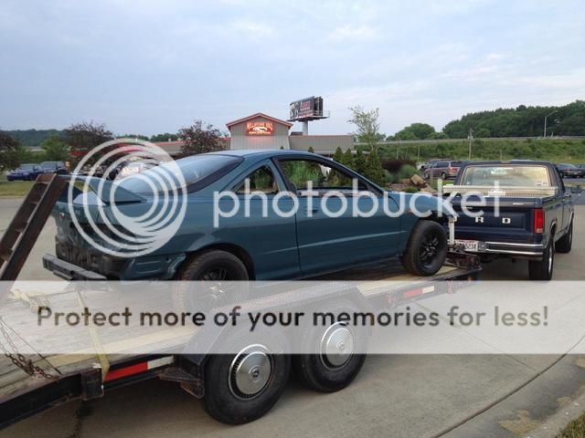

Picked up my brothers race car project from the paint booth yesterday. Tentatively scheduled the F150 for October. That gives me time to prep the front clip and new bed.
