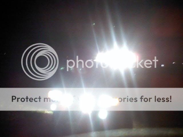

I also snapped some night time pics
-plumcrazy
Think you got enough lights on that beast yet?
Nope, I want to take of the side emblems and put some marker light/turn signals there.
-plumcrazy

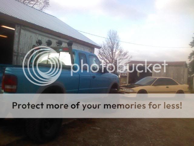

My brother was working on his car too, so I grabbed a pic
