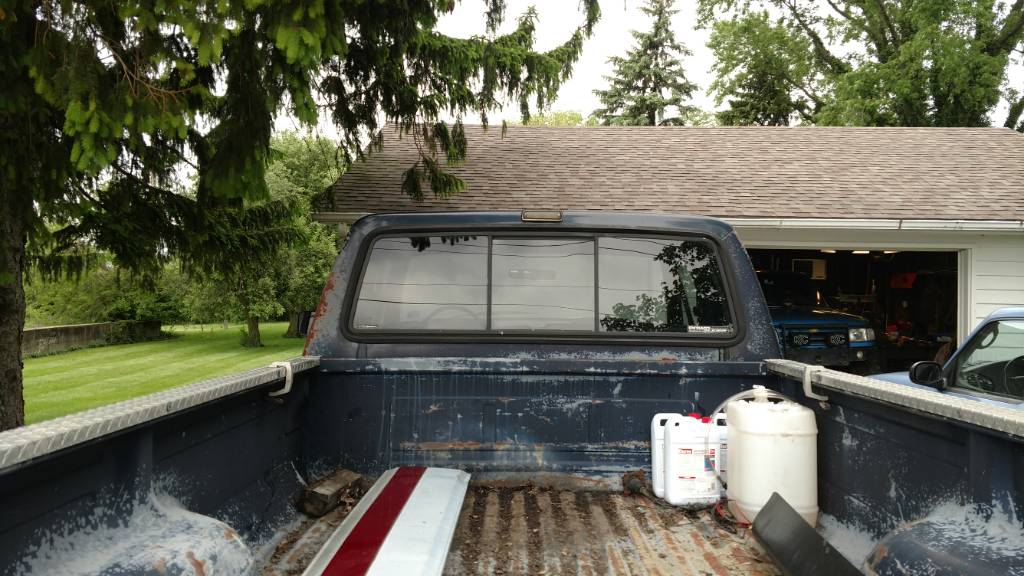

I don't plan to really clean up body much, it's not rotted so I will probably Fluid Film it and rock the patina.

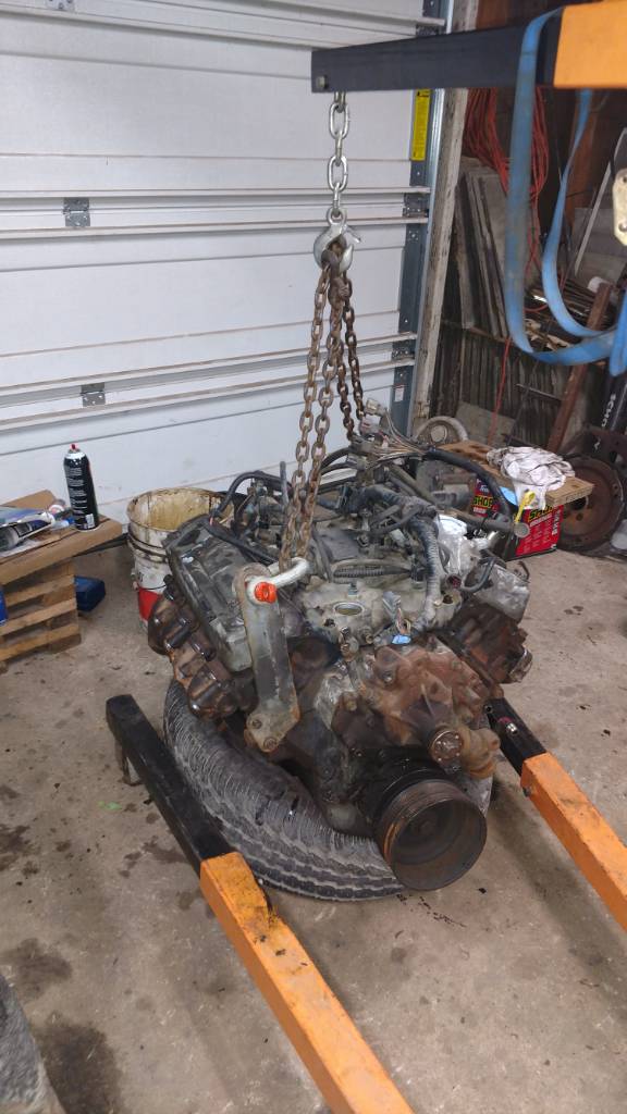

Still no progress on the Ranger...but the dually has new power plant that is almost ready to go in.
95 460 bored .030" over, I replaced/ing all gaskets and valve seals as well as going to pre 72 cam timing.
Hopefully has a little pep.

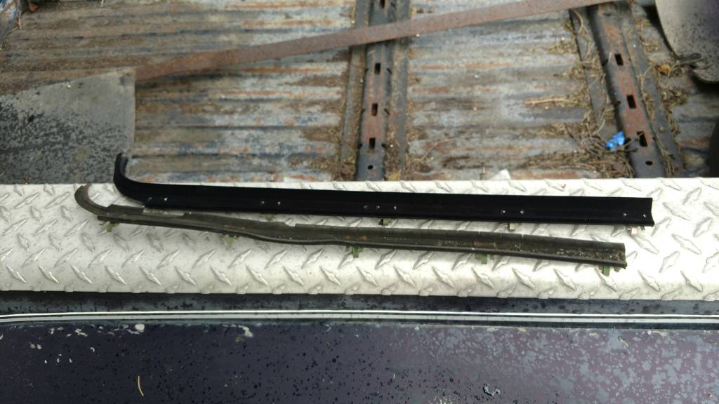

Also sporting a power slider and fully functional power doors.lol
The weather seals were sunbaked and let the motors/actuators get wet in the doors, so I had to replace the motors and locks. Stripped the wrinkling tint off too.

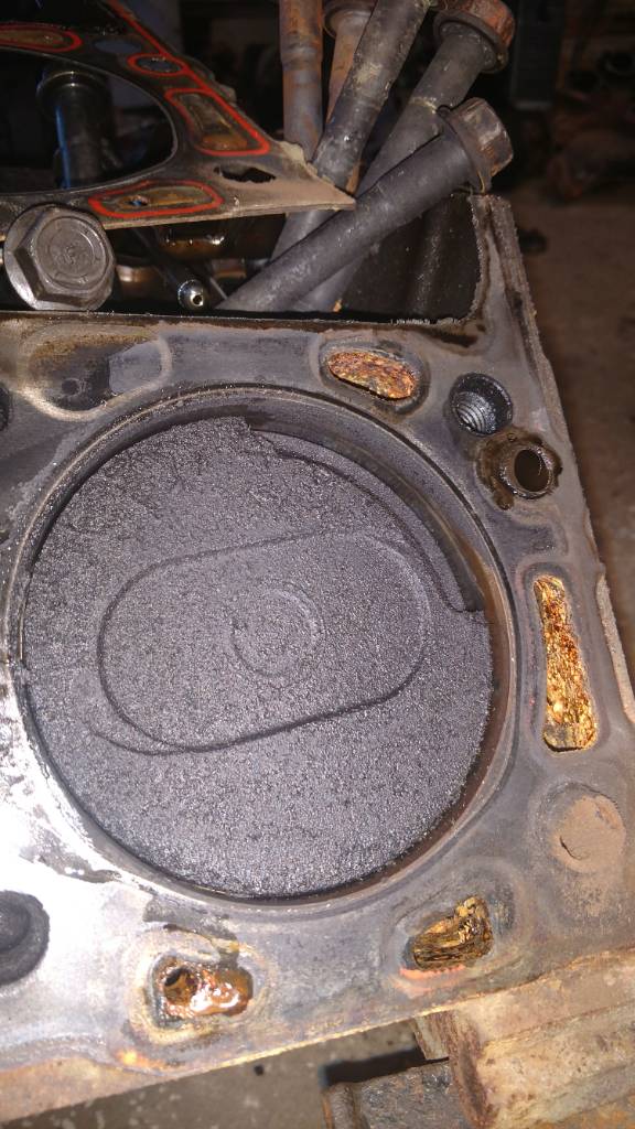

Also pulled the heads on the original engine...turns out this ole big block has had a hard life.. notice the large chunk of the #1 piston is MIA..
