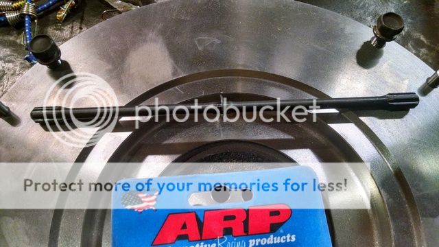

Parts showed up yesterday, got home from work late and had put brakes and a wheel bearing on a co workers truck...but I did get the oil pump shaft in and primed it with a drill. All I need now is my cam sync tool and its go time.

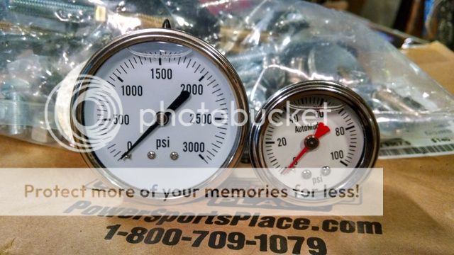

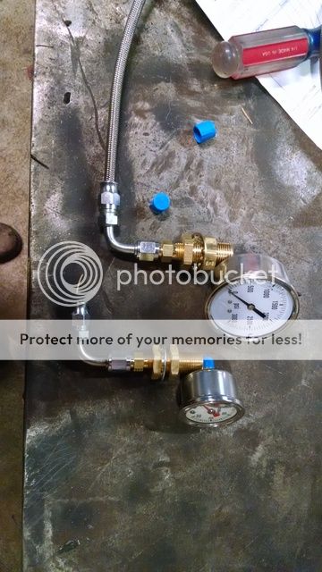

I pieced to together all the fittings and hose Ill need to ad some pressure gauges for power steering and fuel rail. Both will be mounted on the cowl and protected by some sort of scoop/pod.

I bought 3000PSI Summit PTFE braided hose/ends...expected to be an awful assembly like the stainless AN stuff I have used in the past...I was pleasantly surprised to find out the stuff is cake. Really don't want to commit to mounting until I have the motor in and can check hose routing and clearance.

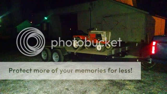

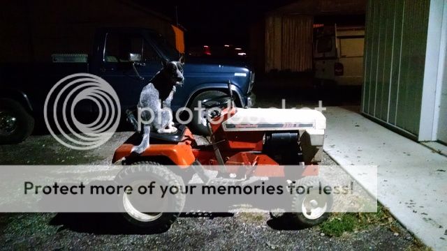

I did pick up a new toy. Simplicity Frankentractor.lol Its a 7010 chassis, with 3310 sheet metal, and a newer hydrostat and PTO drive. Ran and drove great, but the carb needed rebuilt to run perfect. I also changed all the gear box and hydro fluid, wired up the lights, picked up a deck and cart, as well as started gathering parts to add hydraulic lift to the deck/3 point. Once its together I can let my dad have his B110 project back that I have been using.

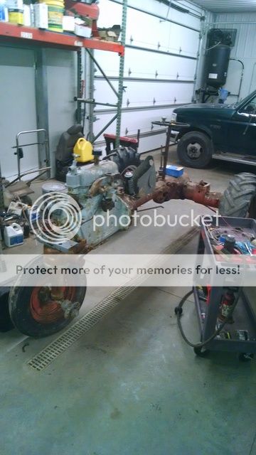

Also Dad and I got the 1941 Allis Chalmers C project fired up for the first time since the 80s when the previous owner tore the tractor apart. We brought this thing home in boxes last year. sanding it all down and spraying some paint soon. Broke down and bought two new rear tires...little boogers are pricey.

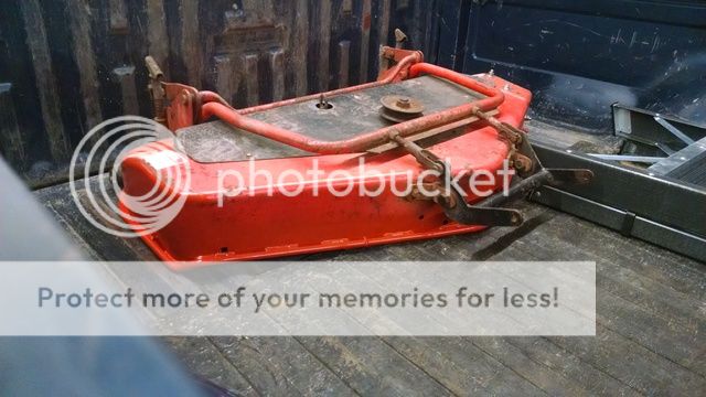

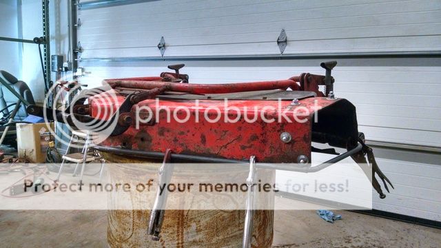

New mower project now has a refurbished deck ready to roll.

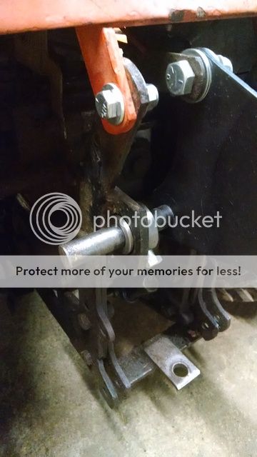

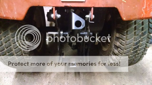

Also made a bushing and cleaned up a sleeve hitch for the rear.

The little Allis Chalmers C got some color.

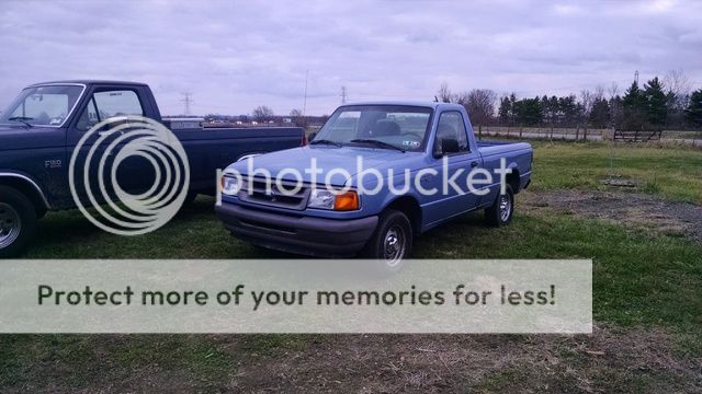

Also added another blue Ford to the fleet...thanks OneBadEx!

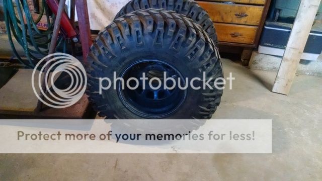

This C is a 41. The oil breather is aftermarket, came with the tractor, but pretty sure it is similar to the original. These tires are actually only 9.5s.lol It had one original tire on it and it was a 10.00..which is no longer available. I picked up a set of road grader tires for super cheap we were going to use on the rear..but they were 14ply and too stiff to mount. Somehow the previous owner go them onto the Cub Lowboy wheels though. So we bit the bullet and bought new. These are BKT tires from India.lol Same tires I put on my 45.

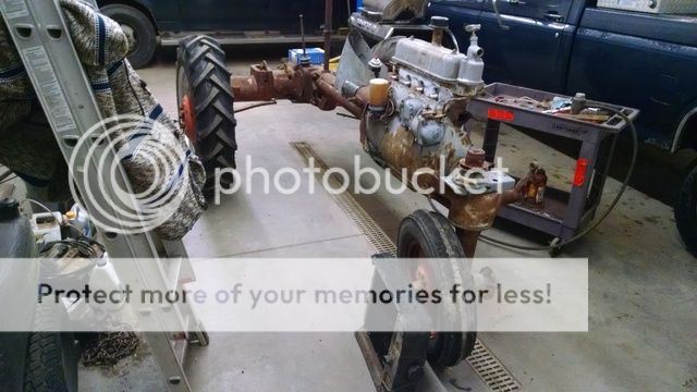

I paid a visit to the AC salvage yard up were I went to school and scored most of the big items for fixing up the 17 like sheet metal and frame rails. Luckily the tires look salvageable and we have a rim to replace the extremely rotted one. We planned to pull the motor apart this winter..but somehow the C jumped ahead of it in line.lol All started when I drug home those grader tires...then they wouldnt fit...so we bought new...then said screw it, this thing is basically already torn down for paint anyways.

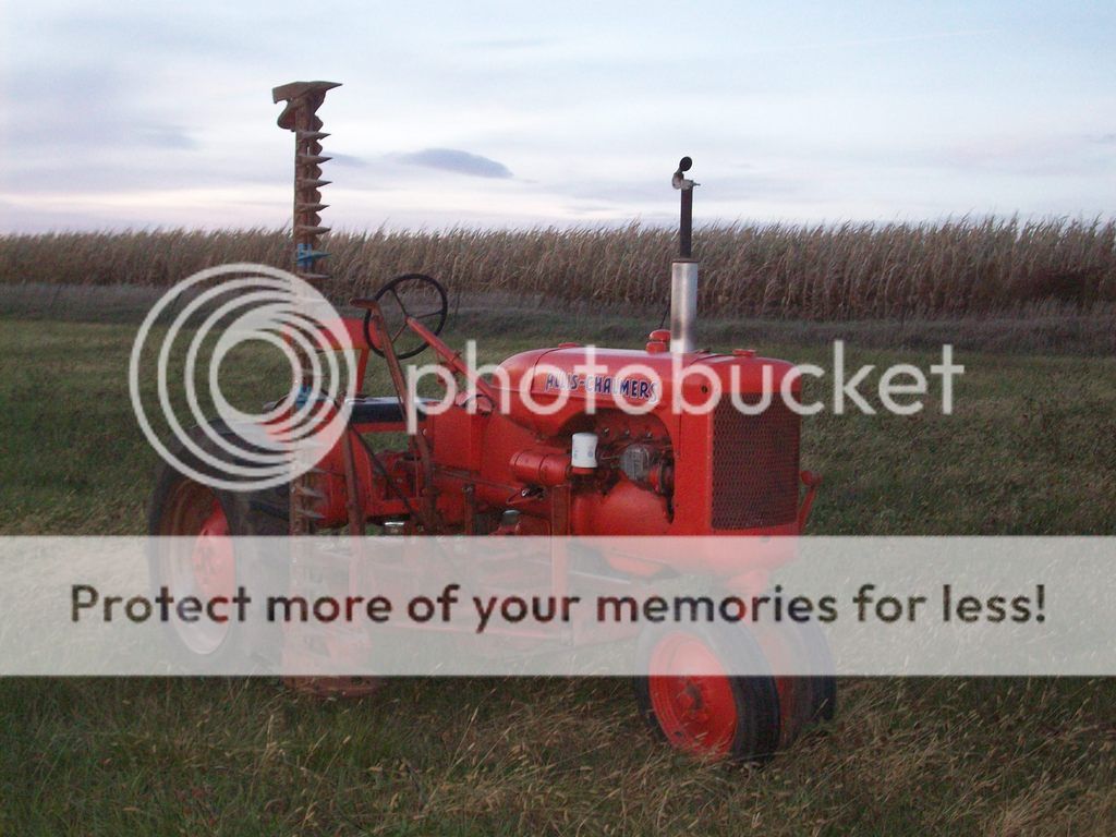

BTW We have two of those crap coupler blades. One has the "box wings" and one has bolt on straight extension wings. The one pictured was bought new by my great grandpa..the other came in a package with a 45, plow, half set of cultivators, and the better half of a rear mount sickle bar.

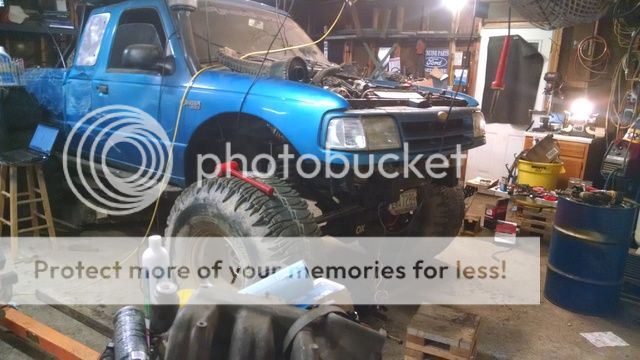

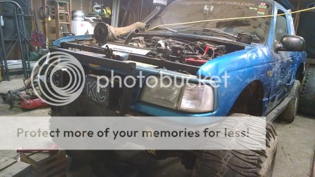

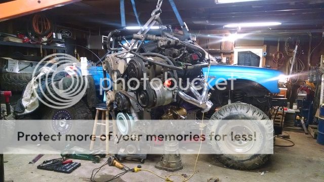

The new motor is off the stand and in the truck and the front clip is back on.
PlumCrazy's Build
PlumCrazy's Build
PlumCrazy's Build
PlumCrazy's Build

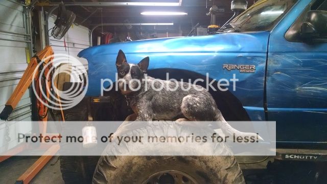

Of course my dog/cat was there to supervise...
PlumCrazy's Build
Only thing left under the hood to do is a heater hose and the EGR tube.
Once the transmission is in, I can build the new exhaust (with a muffler finally) and fire it up.
Once the rest of the drivetrain is in, Ill build the track bar mounts and burn them in....then all that is left is build the 8.8 and route the front locker shifter cable.
