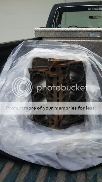

I did pickup my block, pistons, and crank from the machine shop....so when I get some down time....I can put the short block together and swap my heads over.

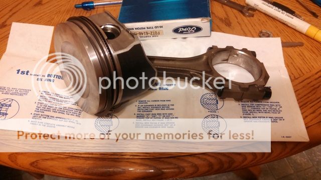

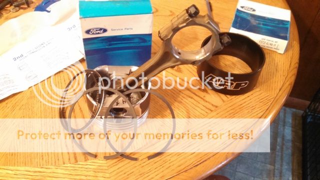

ARP rod bolts are in, big ends of rods resized, wrist pins pressed through the new slugs, block cleaned and honed, crank polished and ready to rock. Shop told me the cam bearings still looked new, so he didn't touch them. Should just be a matter of bolting everything together and checking clearances.

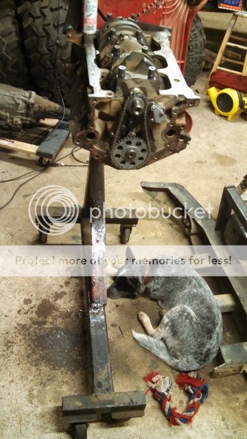

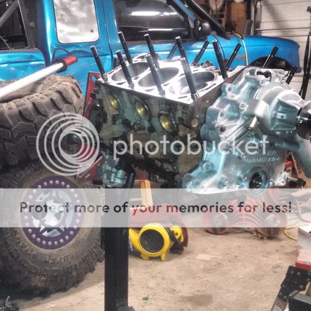

Assembled the bottom end!
Everything was at the high end of the "ideal" clearances, but well within allowable.
PlumCrazy's Build
Dingo did his best to help

I picked up a fancy single bore size compressor for 100mm bore, but standard 4.0 bore is 100.4...so I just chucked it up in the lathe and took hair off with some emery cloth.
PlumCrazy's Build

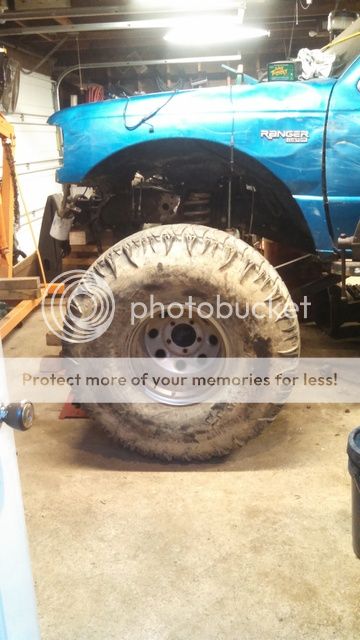

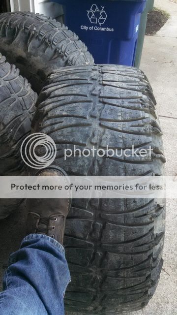

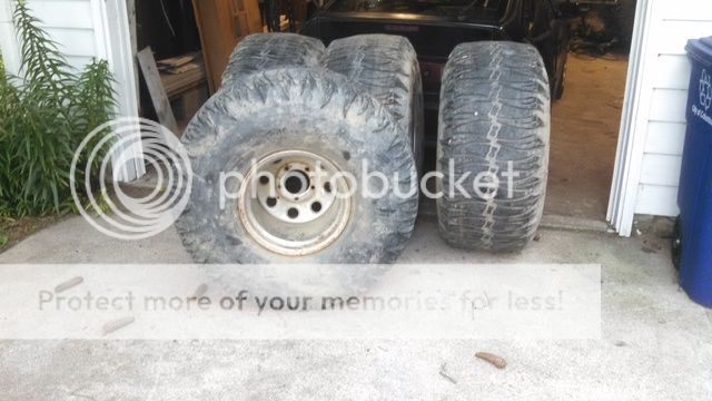

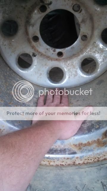

Picked up these little fellas for pounding pavement around town. 39.5x15-15 TrXus STS on 15x15 wheels. They are big and half bald, but they were cheap and on 5x5.5 rims...lol
PlumCrazy's Build
PlumCrazy's Build
PlumCrazy's Build
PlumCrazy's Build
Im 99% sure it wont fit in the garage with them though:annoyed:

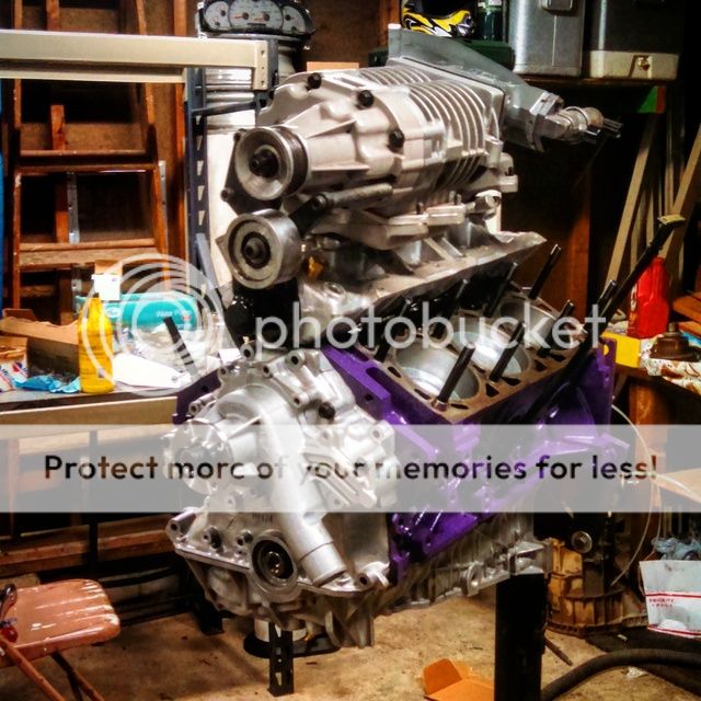

Little teaser...
PlumCrazy's Build
In reality...once the engine is in the truck...the purple will never be seen again.lol Just basically makes it look good on the stand for a few glamour shots.lol
