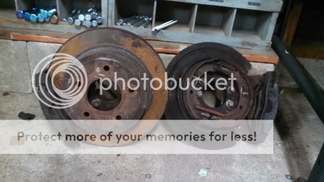

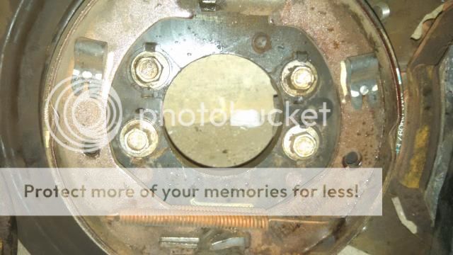

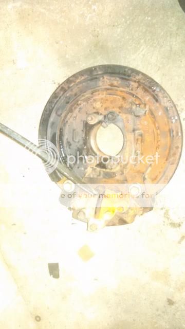

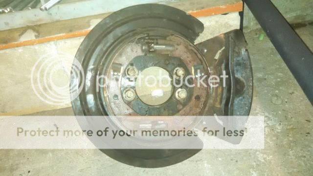

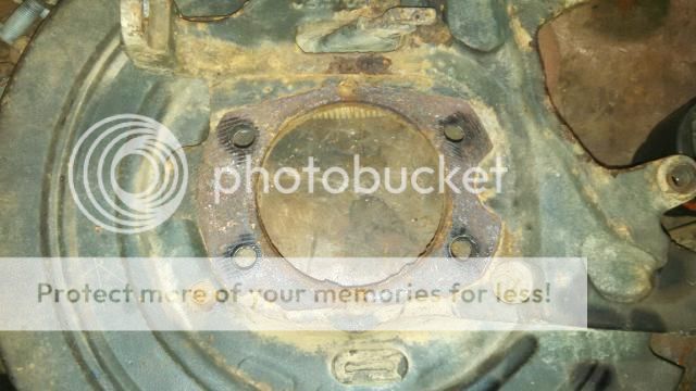

Soo. The brake research I did was a pretty big letdown honestly. I found that the 05 E150 still ran the 5x5.5 pattern 8.8 and a had 13” vented rotors. The Police model uses phenolic pistons and the civilian used steel. I was excited to upgrade to vented rotors and the much larger parking shoes. Unfortunately after pulling the axles and removing the entire backing plate assy from both sides in the 10* snow storm I got it all home only to find the backing plate to axle pattern is different from the Explorer/OBS 150 pattern. The Expo pattern is a perfect rectangle bolt pattern, where the E150 setup uses a trapezoidal pattern. The lower bolts line up, but the upper bolts are spaced too far apart. I am unable to modify the pattern on my axle since I will be running the Yukon semi-float conversion flange. The Expo caliper bracket/backing plate limits the rotor size to just over 11” and the caliper cant except anything thicker than the solid 14mm Expo/Vic rotor. I have heard rumors of a vented rotor that will fit in the Gen 2 Lightning caliper (what I am currently running)…not sure if that means it can be retrofitted to the Expo diameter setup though.
If anyone plans on running full-width half-tons, I would recommend looking for the newer E150 8.8 with these monster brakes. Or if anyone with an Expo 8.8 is willing to rework the axle flange to except the trapezoidal pattern, they could have a killer setup. I am assuming the setup requires 16” or larger wheel, but I have not confirmed. It appears the Expo parking brake cables can be used as well.

Here is what the setup looks like. It has the caliper bracket setup similar to the 95+ Ranger front setup.

Seth, can you make slots in the bolt holes of the back plate to match up with you axle and then add an alignment pin at the 12 o'clock setting as an extra precaution?
Or what about filling the upper holes with small patches and then re-drilling to the correct pattern?
I don't really want to get into a modified cast bracket. I rather build new out of 1/2" plate. Honestly the combo I have now is great...especially with Hydroboost, but I prefer vented rotors for longevity of the setup. The heat from solids can break down everything faster.
