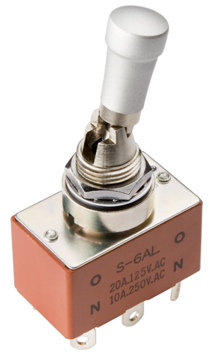

I still need to figure out how I am doing the track bar, how I am doing the hydro cylinder, front drive shaft, and how to route the shifter cable. I want it mount in the console with the other shifters, but IDK if my current cable will be long enough. I could convert to air or elctric and just get two matching switches for the front and rear lockers. I am looking at a HD locking toggle like this for the rear.
It needs to be big enough to look like a "shifter" lol. So I can say its Penta-Sticked
