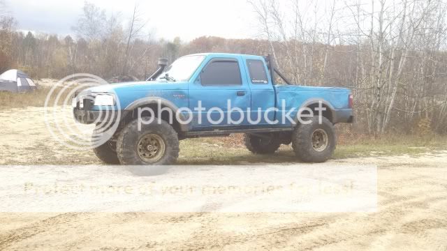

His Ranger measures 83" from sidewall to sidewall. A little narrower but with a wider tire. So his rims have less offset and dont rub his link bars. What are you guys doing wrong lol?

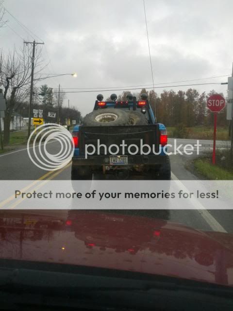

Last light before the park...
I picked up some cheapo floppy mirrors to wheel with.

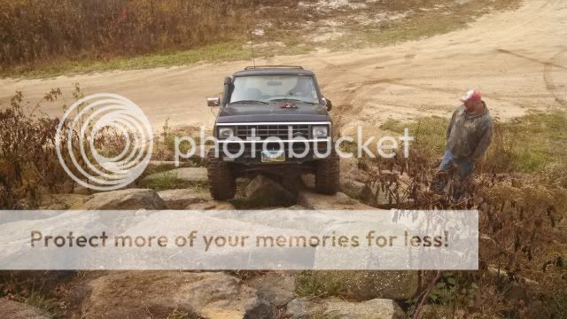

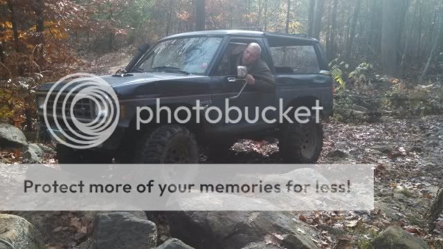

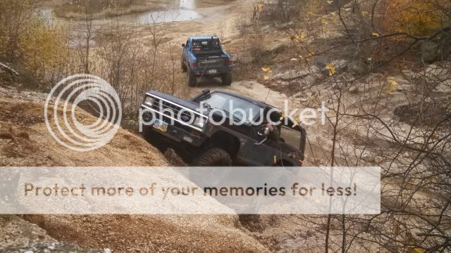

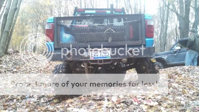

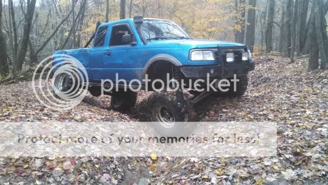

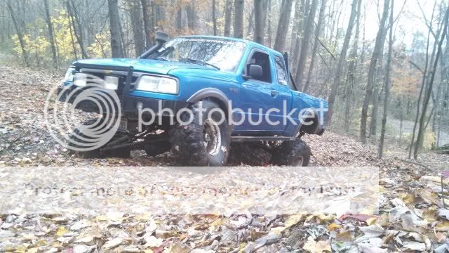

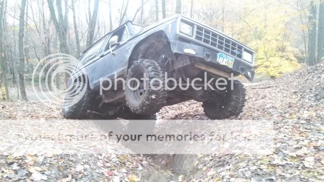

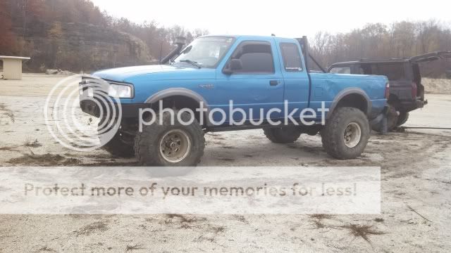

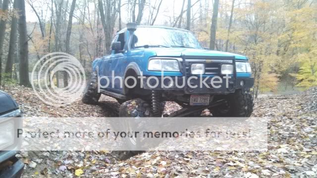

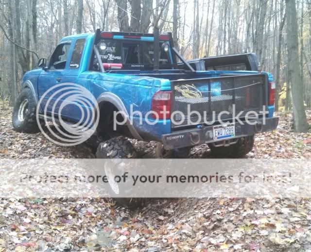

A few pictures from Saturday's trip. It was kind of a blah day. It was drizzly rain and slick.
I got hung up between two trees on Knuckle Buster and kept sliding into my left side.

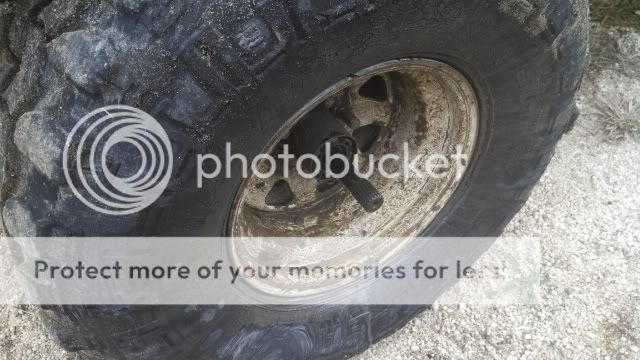

Popped a shaft around 3pm and called it a day. I wasnt even pushing it hard when it popped. Just cruising up Blueberry Hill and...pop. I looked expecting to find a blown joint, but both were good. Pulled the lockout the issue was obvious. lol

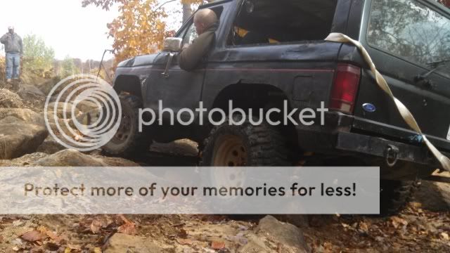

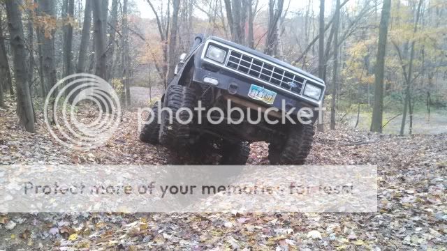

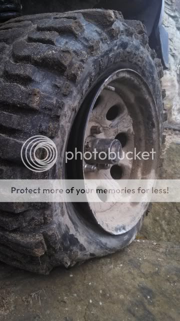

The B2 debeaded a tire as usual, but luckily his OBA is kick ass.
FYI....the pictures of the B2 "flexin" are in the same exact place that I took the pics of my shopping cart suspension.

You must have 1 ton springs in the B2 lol. Its half the length of your Ranger so of course its gonna get tires in the air quicker then a Supercab. Besides a popped bead, nothing broke on the ttb with Boggers on it? Howd the big, tough D44 hold up with TSLs ;p
Not exactly a fair comparision... b2 33" boggers half the weight half the gearing... big surprise it breaks less. Ranger 38.5 tsls way more gearing probally 2000lbs heavier..
Btw. I'll be the first to admit that your homebrew suspension flexes ALOT more then my ttb. And maintains proper steering geometry as it flexes. Thats what I dislike the most about the ttb setup. I still think a tire over 35" requires more then a 1/2 ton diff lol.
The TTB is open diff on 31s....locked it would be in pieces. I was on 36s back then. Its not the tire size killing me...its the gearing.

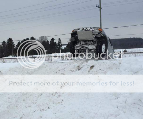

This trucks open diff and michelin xls (36s)
Hasnt broken yet but the tires are skinny and dont grab anywhere near what an interco will
But no matter what the dana 35 ttb is nowhere near as good as a 44 in any respect. I was blowing shafts at will on 38.5" boggers with a 3.0 and 3:73s.... my buddys ranger is a 302 on the same tire with a 44 and fine
The pic above just shows how great TTB is at plowing into stuff.lol. Snow caked on the ole mud plow.lol
