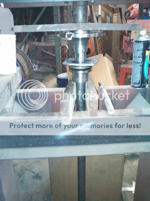

Pressed the bearings and retainers onto the 8.8 shafts

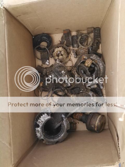

My RCV inners showed up

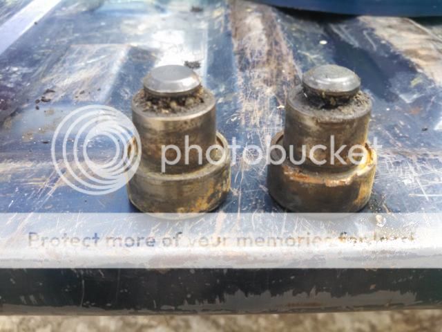

Three Warn premiums and 2 D44 balljoints.."Craigslist Mint"

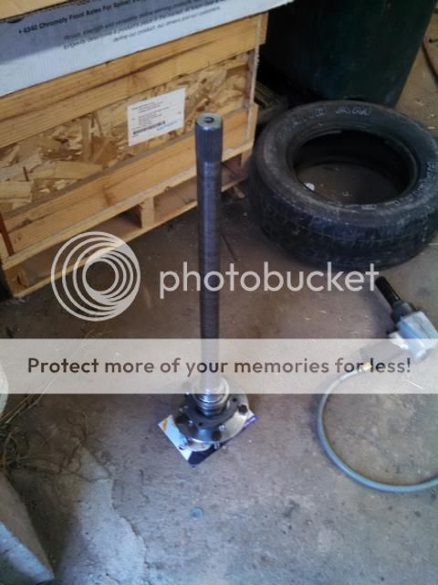

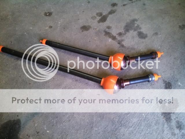

OX joints and Yukon 4340 shafts

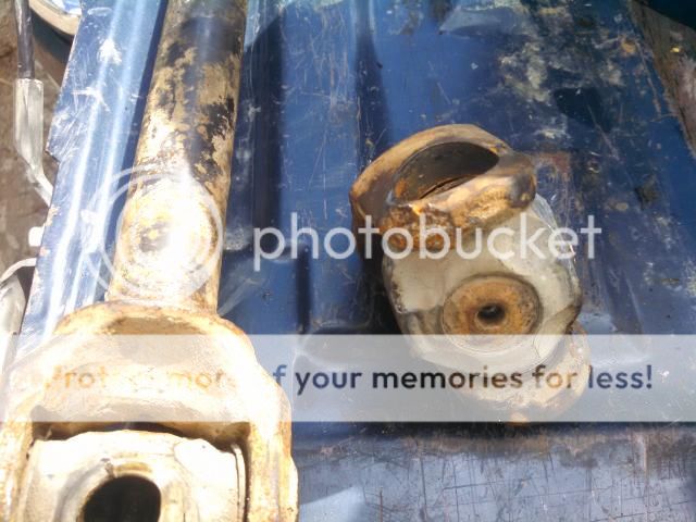

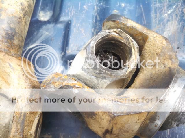

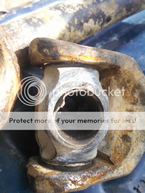

Honestly...I am not sure what let loose first. I was blaming the ears on the shafts...but it looks more like the inner retainers on the joints let loose first allowing the caps to walk out and catch the ball joint nut.
Either way it sucks!
