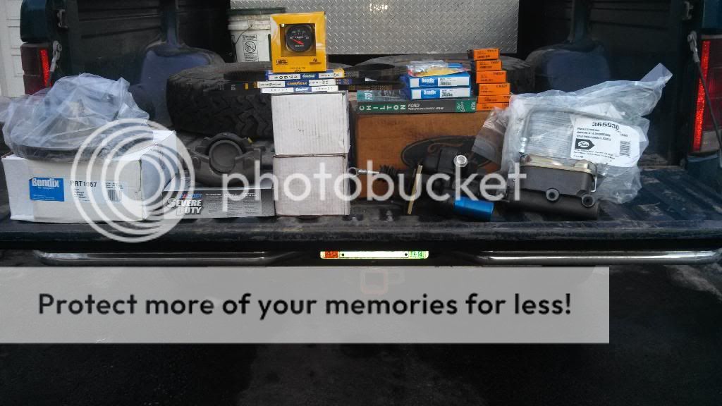

I had the wheels off to do front shocks, and I noticed the driver rotor was pretty grooved. Turns out the slide pins were frozen and the outer driver pad is toast. So I did the only thing that made sense to solve the issue....I picked up new bearings, rotors, pads, big piston calipers, hoses, 1-Ton 1.125" bore master, and a hydroboost unit.

I love that frozen slide pins lead to a hydroboost upgrade :icon_rofl:
That thing is going to put you through the windshield when you tap the brake pedal. Did you fix the fuel tank selector valve? And what are you going to do about the hub caps?

In the end I will have the brake setup as the Ranger.
