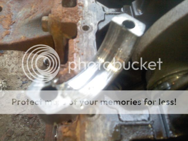

So the tear down began. Found the oil pump drive was shot and the mains and rods locked up.

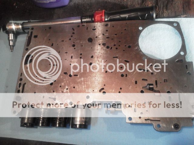

So replaced the notorious separator plate gasket.
It still shifteded like poop.

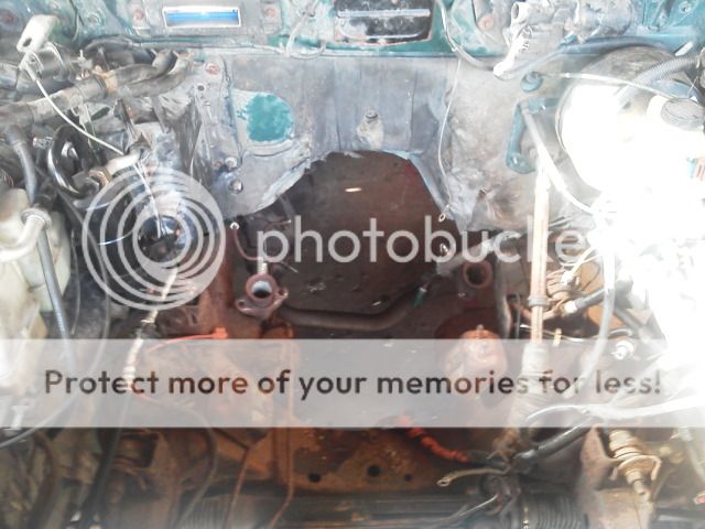

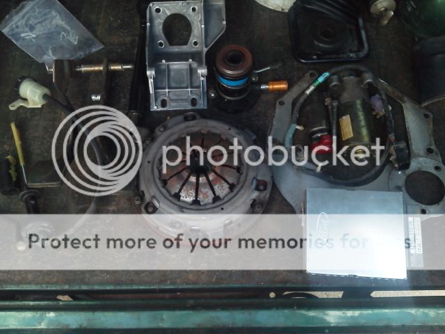

Swapped the 5 speed in this past weekend. Feels great to have a real transmission again.lol. This truck was my first automatic, and we all see how long that lasted.lol
Everything was bolt in and go. I didn't have the manual floor plate with the precut hole, but I was able to pull the boot off of my brothers 03 and measure out where it needed to be cut.
I lucked out on the manual ECU. Turns out it is a non PATS model, so no reprogramming was necessary. I pulled the column and stripped off all the auto shifter junk and installed the manual column cover and cluster block off plate.
Looped the neutral safety and spliced in the reverse switch pigtails. Starts runs and drives like a factory 5 speed. Only two things I still need to address the the theft light blinks for a minute ir two after startup and 98+ auto trucks dont have the plug with a jumper to easily plug in the clutch safety.
