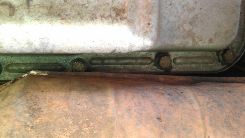

This was my thorn in the side as far as dropping the pan...I thought I'd NEVER get that dang bolt outta there!! & I'm sure its gonna be loads of fun trying to get it back in! Geesh! Should I have removed that other piece?

The other piece looks to be exhaust. Try giving it a gentle pry to move it out of the way.
