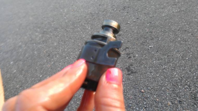

Ok, so I got the TCC Solenoid out & had it tested (twice!) & it's not the culprit. Checked the TCC Solenoid valve, which was also fine. Removed the entire control valve body & had all valves checked, which were also ok. So now I reckon I'll put it all back together after work this morning & get back to the drawing board. Will unplug solenoid kit from outside transmission & see what happens, as I was told by tranny guy in town that if it works with it unplugged then I have an electrical/computer issue and if it doesn't then I can continue on with my transmission investigation...which will include replacing the TCC itself next ($150 if I replace it myself, which I should be able to do with what I've accomplished thus far). Sigh...now I remember why I'm a nurse & not a mechanic!! :icon_confused:

remember....my connector at the trans. was faulty also.....just saying....if it's a connector (pin) or a bad wire in the harness--wouldn't want you to spend $150 for nothing......
