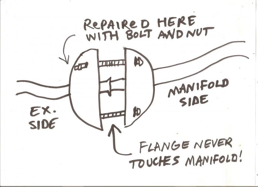

I found a crack in my exhaust manifold and replaced it with a spare I had. While removing the spare manifold from the old pipe at the flange, a bolt broke. Since I couldn't remove the broken bolt successfully, I drilled a hole through it so I could just use a bolt and a nut. Now I cant get the pipe and the manifold to seal properly and it leaks badly there. I have called many muffler shops to see if they could weld the pipe straight to the manifold but I get the same answer which is NO:annoyed: Any suggestions for what to do next would be great.

Yes Mark, it's where the manifold meets the down pipe. So one of the two bolts holding the manifold to the downpipe by the flange broke off inside the manifold bolt hole. I couldn't get it out, so I drilled a hole through it and now I am using a bolt and nut instead of the original exhaust bolt. I cant take a picture right now unless I take my computer outside and use the webcam (or park my truck in the living room). It looks like there is no Gap at the joint, but I never saw any sort of gasket or anything.. I wish somebody would just weld it to the manifold for me but the shops seem skiddish for some reason.

Ah okay I just looked it up on Oreilly's website and it looks like the shape of the flange, but my flange is the type that doesnt actually come in contact with the manifold;
