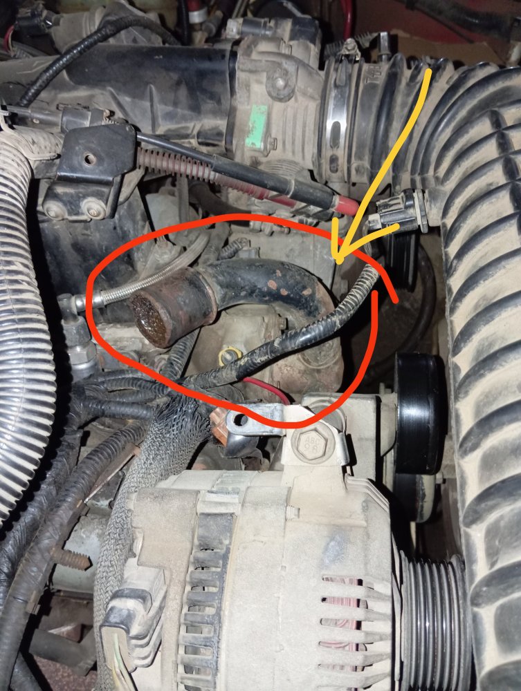

Could anybody tell me what is the name of this pipe?. It has a lot of rust inside, so I want to replace it, but I don´t know what is the identification or part number.

So tiny I can't see it.
That's your thermostat housing. It isn't worth trying to replace the pipe on the housing. You'd spend more in materials and time than just purchasing a new housing.
Here's a link to the Rockauto listing and it shows prices ranging from less then $10 up to about $20. Your profile says Mexico and I don't know how that affects pricing and shipping, but you can probably use the part numbers to find similar listings and prices in your country.
https://www.rockauto.com/en/catalog...ystem,thermostat+housing+/+water+outlet,10337
Remove it, drop it in a pail of vinegar for a day or 2. The weak acid will remove the rust and not affect good metal.

Thank you very much for the answer, and the data
