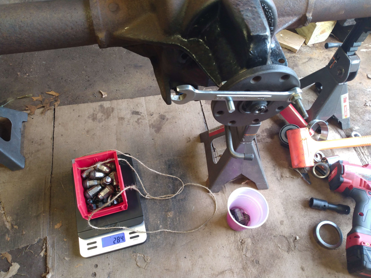

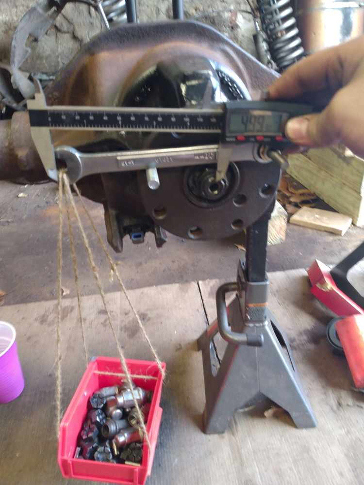

Here's how I set up mine. You're supposed to do it without the differential installed.

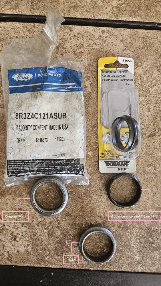

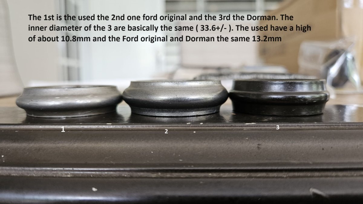

In my case....
Due to a noisy differential I disassembly the entire differential just to find a broken teeth in the ring and i buy a new ring and pinion and no crush sleeve in the box,not included. I have doubt about the crush sleeve to use because can't find any specification so i tried to find one and find a replacement at Advance auto that said "exact fit" for my Ranger a Dorman brand and a friend of mine also bring me a new one,a Ford original part, but he is not secure if works for my Ranger so i measure the 3 and get this:

In my case....
View attachment 114428 View attachment 114429
I didn't have much luck with it and the pinion got a little loose after a thousand miles. I rattled it tighter with the impact and never had an issue again.

In my case....
when either of the 2 new crush sleeves get installed and crushed they will look exactly like the used crushed one.
as long as the inner diameter is the same they are good.
Ok,thanks

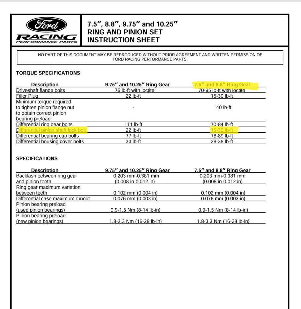

Well, i found that in my case according with Ford the preload is 15 - 30
