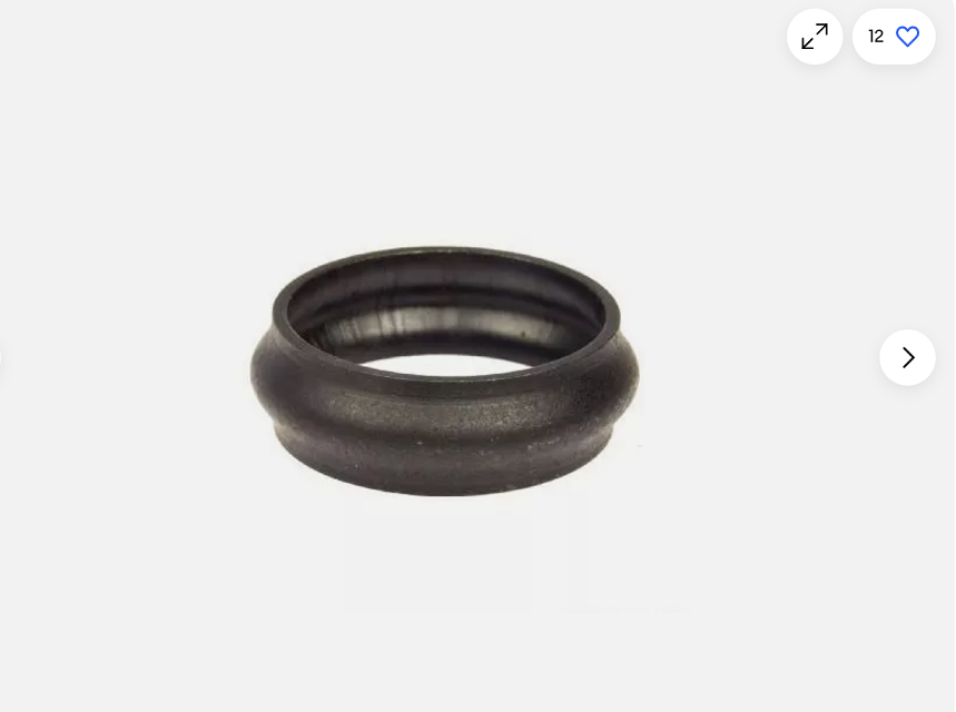

....And is necessary to change the crush sleeve or you can still use the old one? my new pinion and ring comes without a new crush sleeve...Are all crush sleeve the same i need one for my Ford Ranger Splash 1995 3.0L V6
New sleeve.
Once a crush sleeve has been used, it has been crushed and is no longer the original length. When new components are installed, tolerances may add up differently and the crush sleeve may need to be a different length to get the preload correct. Best practice is to always start with a new one.
I learned on Ford 6 3/4, WER, 8 and 9 inch rears but the principle is the same- the bearing preload is the critical spec you're trying to hit. I install pinion nuts with my 1/2 impact and check preload once I feel the crush sleeve squash.
Never reuse a crush sleeve unless you want more practice setting up a rear end.
Thank you people but still with doubt about the crush sleeve of my Ranger 1995 ,is 7.5 and 3.73 ratio.
