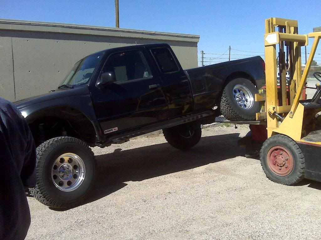

Playing with a fork lift to get a better idea of how the rear suspension will work with the proper shocks.
Holy CRAP! That's some crazy droop right there. I want a set of those leafs now!
