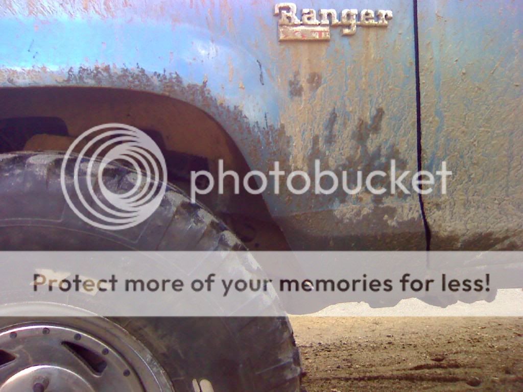

this has some perspective with 33's and oem type axles

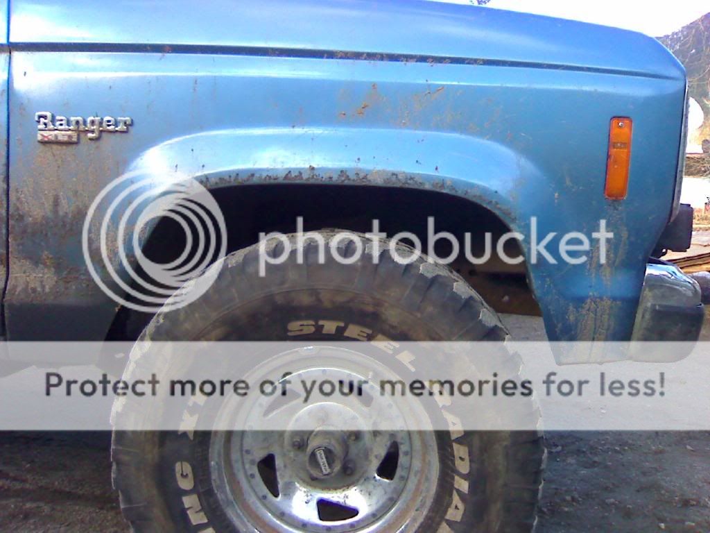

this allows some idea of the lip fold and form on the drivers fender

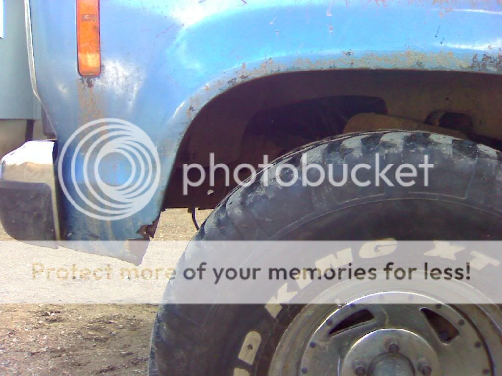

side view with mud extensions
sorry i dont have any good pics

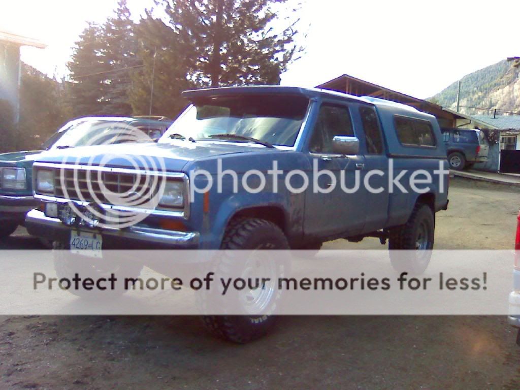

this is how it drives down the road today
these pics span about 7 years....and yes it is a little lower currently then in the ttb pics. with ttb, 38's were about it for tire. with my current setup the 44's fit fine but it rides rougher and has less articulation. as the truck moves into its next iteration, ttb may be comming back!!!! and even if it dont it will have to go up four inches and require even more fender removal to cover the planned mods and will barely fit 42's due to articulation and ride quality goals....
