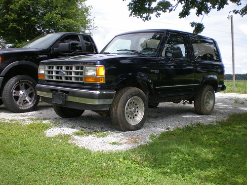

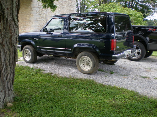

I got an awesome deal on this one. Bought it for a parts vehicle for my 86, but when I saw it in person...I decided to make this a new project.
An older couple owned it for years and hauled it behind their RV. I bought it from the second owner and it had been sitting since 2006 because the tranny went bad.
Theres a little rust on the hood.

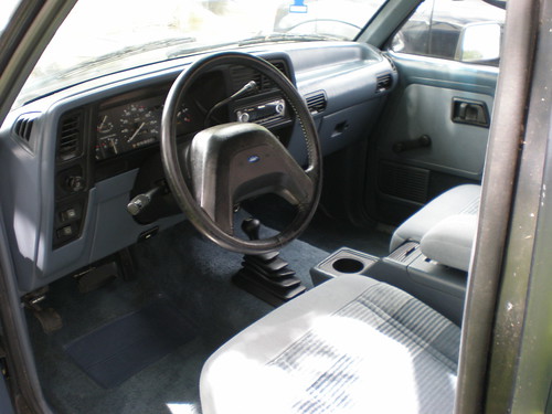

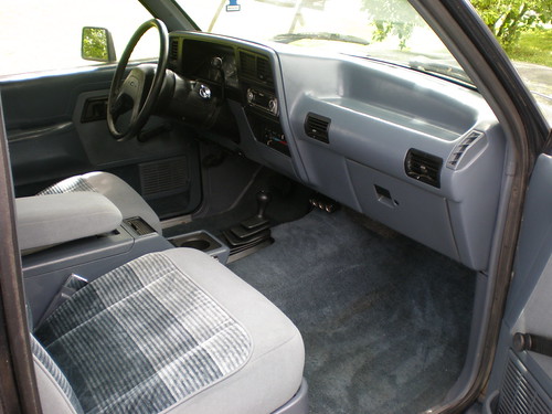

Interior is pretty much flawless!!
more exterior shots:

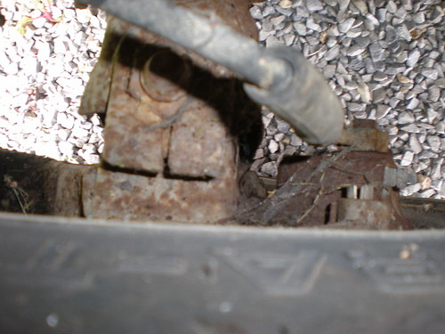

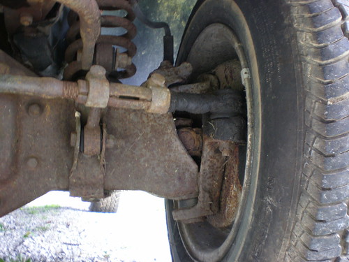

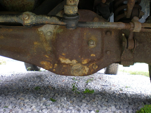

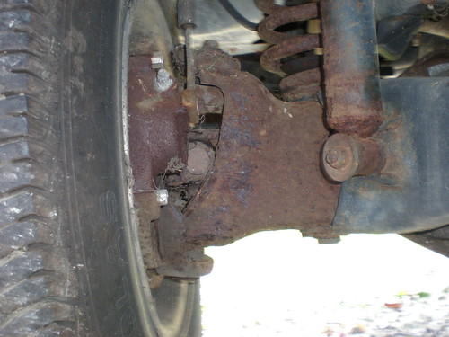

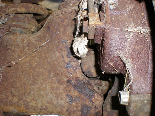

Dana 35

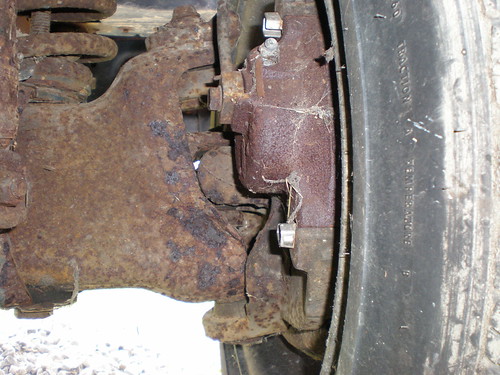

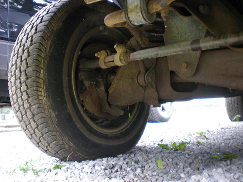

Will this rust be a major issue on the front end components??

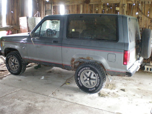

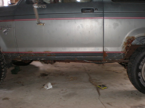

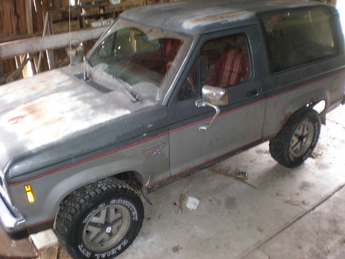

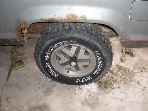

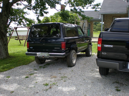

Here is my 86 that is in desperate need of body work (which is what I bought the 90 for)
My plan was to use the 90 for parts...but since it is in such good shape I plan on swapping the drivetrain over. I would like to eventually put a 4" suspension lift on the 90 and run some 31X10.5's (not sure on the wheels yet).

The only time the rust on the suspension components will be an issue is when you want to take anything apart up there. Other than that it will be fine. How do the break lines look?
They are the same way. Surface rust pretty bad. For sitting idle that many years outside (and i live in the rust belt)...i guess that is expected.
