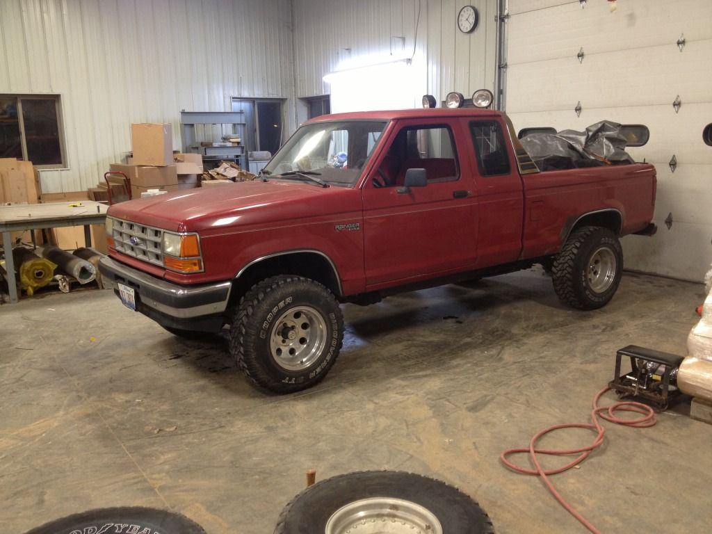

Pre key mod 1.5" crank
shackles and block in the rear

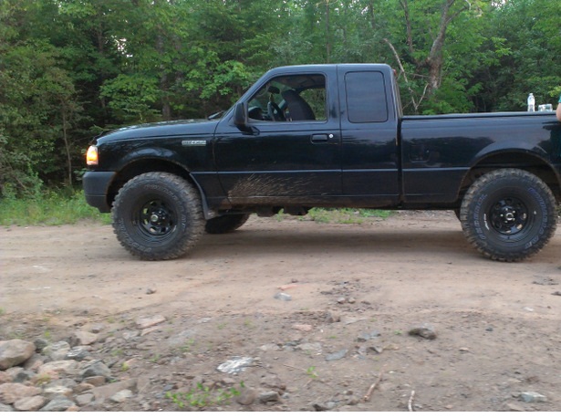

285x75r16(33x11.5x16) federal couragia MT's
2008 Ford Ranger XLT, Stock torsion keys full crank, stock rear blocks. 265 75 16 Cooper Discovery knock offs
Note: The tires did clear without cranking the torsion bars up, however they did rub on the sway bar (very lightly) at full lock.

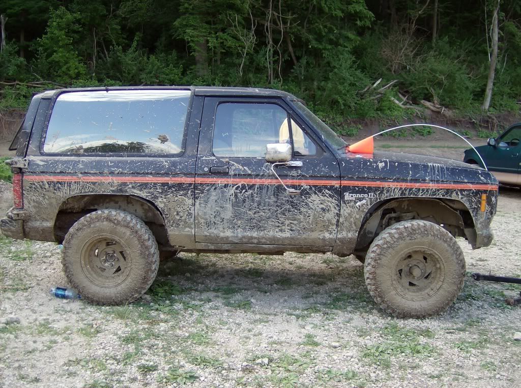

88 B2 with 1" coil spacer's, the flares cut off, sitting on 31-10.50-15 BFG mud terrains.

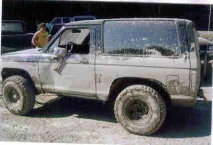

89 with washer mod, 235's
6-7" suspension

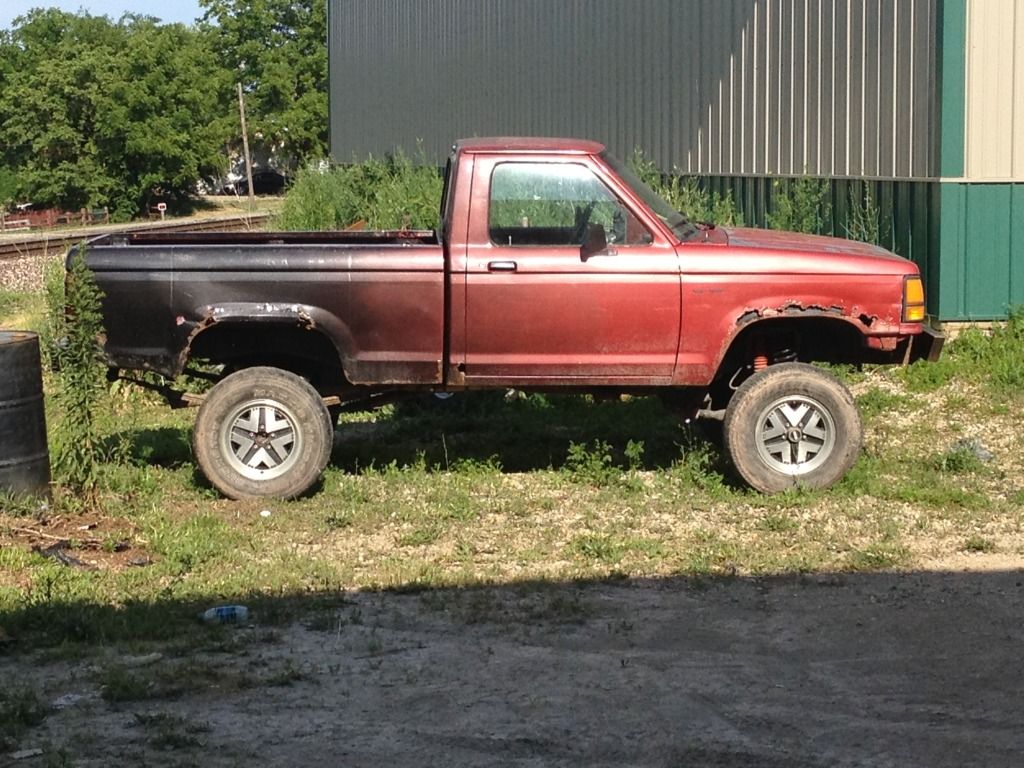

1990 with 3" body and 33-12.50-15 on 15x7's the rear is a little bit low cuz of the 2.9 in the bed

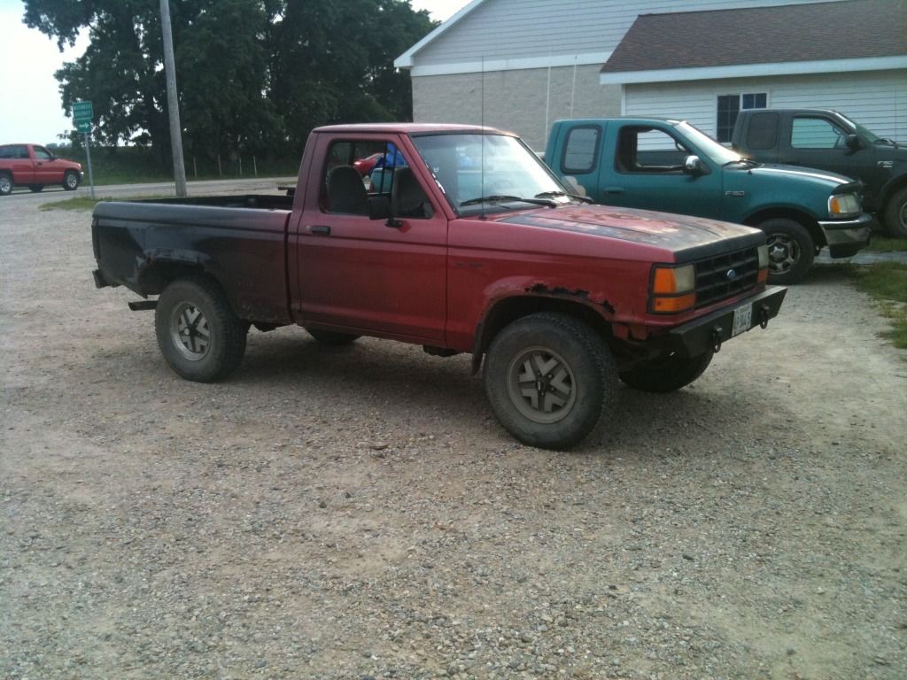

1997 Ranger 2wd, 4" Rough Country Suspension, 32x11.50R15 Kenda Klever MT's on 15x8 Soft Eight wheels.
3" body lift, 2" coile in front, add-a-leaf and '97 Ranger block in back.

Nice looking B2 :icon_thumby:
I had a '87 B2 Eddie Bauer for a little while. I've been thinking about picking another B2 up for a trial rig / mud toy, just don't see to many of them here in FL.
