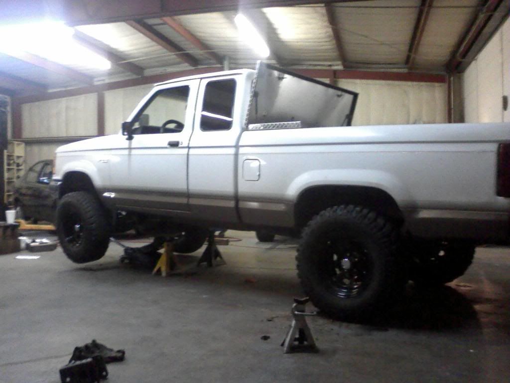

- - -Stage 1 - - -
- - -Stage 2 Coming Soon - - -
-2" Coil Spacers front
-6" Lift leafs rear
-3" Body lift
-Between 33x12.50s and 35x12.50s (Which ever fit best)
-20" Black Rockstars

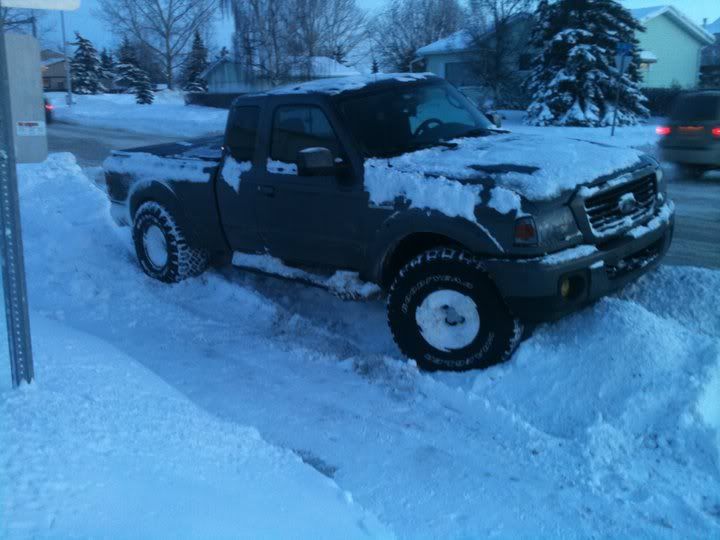

2009 Ford Ranger Sport 4x4
15x10 3.75 back spacing Diamond Racing Steelies.
33x12.45R15 Duratrack Wranglers
Pre mod key, full t-bar crank.
Trimmed the front valance and flare a bit. rubs at full lock. Big ****ing Hammer'ed the front right fender a wee bit.
No issues, drives awesome. buried it up to the doors in snow, and she walked right out. Stock drive line and diffs.
2 inch blocks in the rear
saggy coils in the front

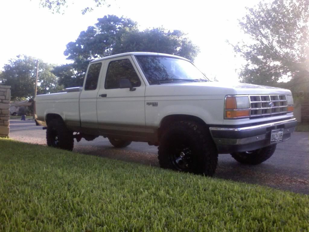

SAS EB D44 with 7" EB lift coils, stock RBV coil buckets
5.5" Chevy rear leaves w/ stock Ranger 2.5" block and 2" shackles
35x12.50-15 Goodyear Kevlars on 15x10 rims with 4" BS

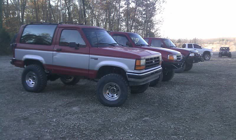

84 B2, 4" susp. 3" body, 33x12.5xr15 bridgestone dueler mt's on 10"rims 4" B.S. no trimming.
