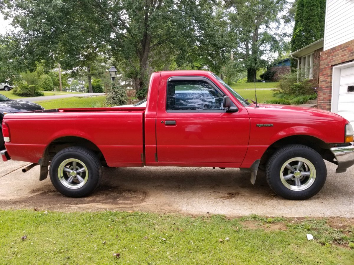

OK, I'll play. This is the low-buck edition. If you're looking for something radical, keep moving. :)
Photos of different wheel/tire sizes on stock and lowered 2WD's
Drop: 2-1/2" rear w/ hanger flip, 2" front with Western Chassis coils
Wheels: '07 Mustang 16" X 7" Base Model
Tires: stock Mustang 215/65X16 BFG's - I plan on a set of 225/65X16 General Altimax HP's when the BFG's are done as the OD of these is nearly identical to the stock 225/70X15's.
Offset: 37 mm
Spacers: 1-1/4" cheapos rear, 1" Eibach front
thanks nice. I have been looking at mustang rims for my 92. Thanks for sharing.

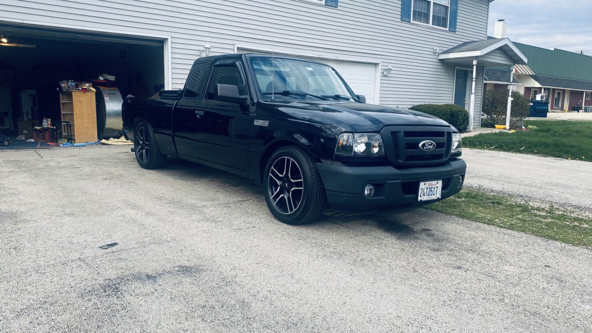

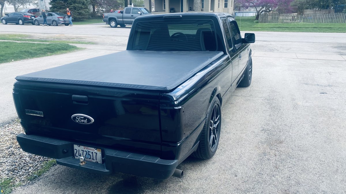

Update. New shoes.

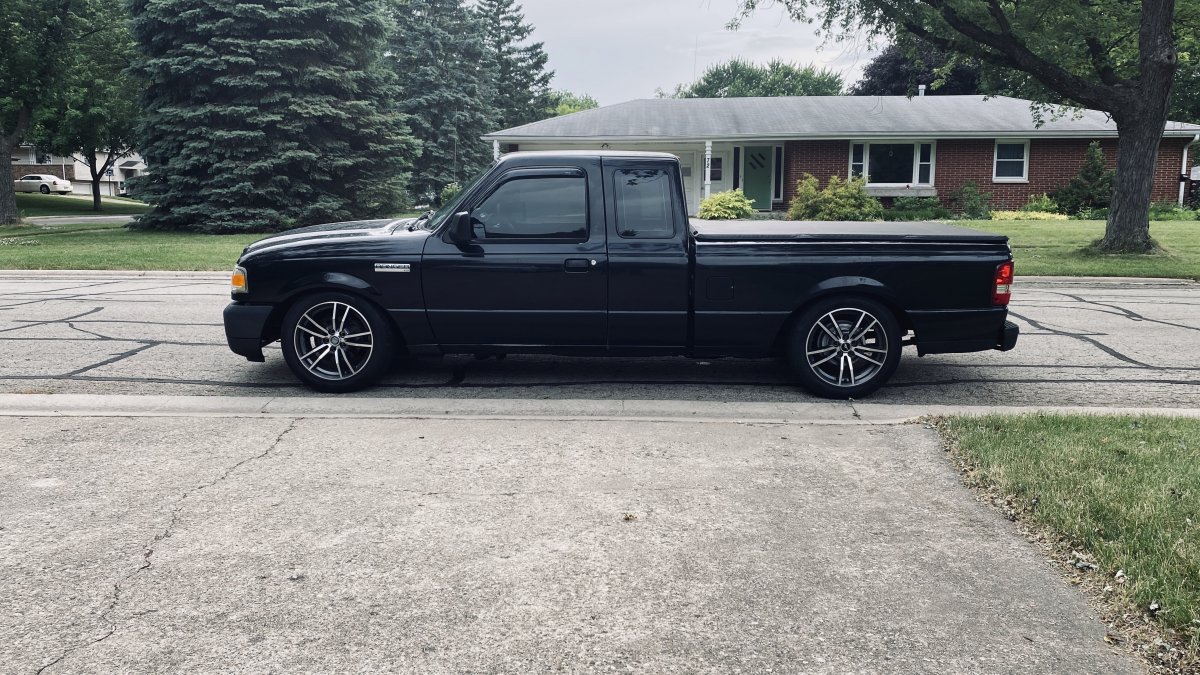

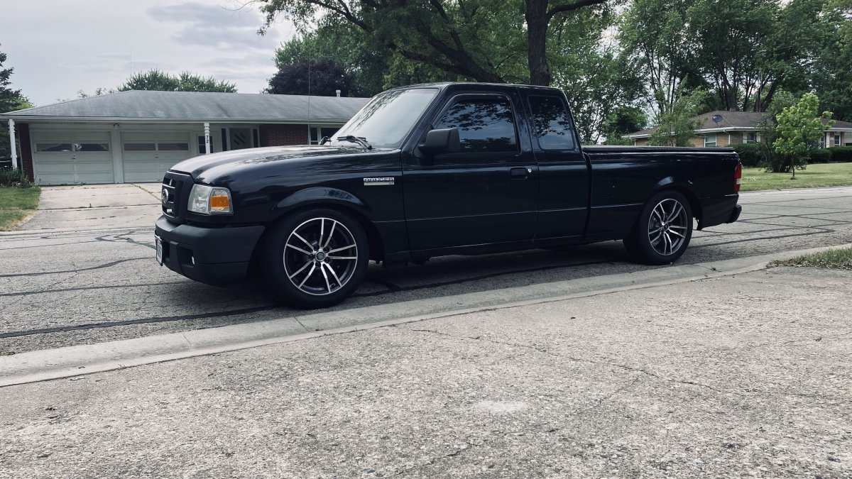

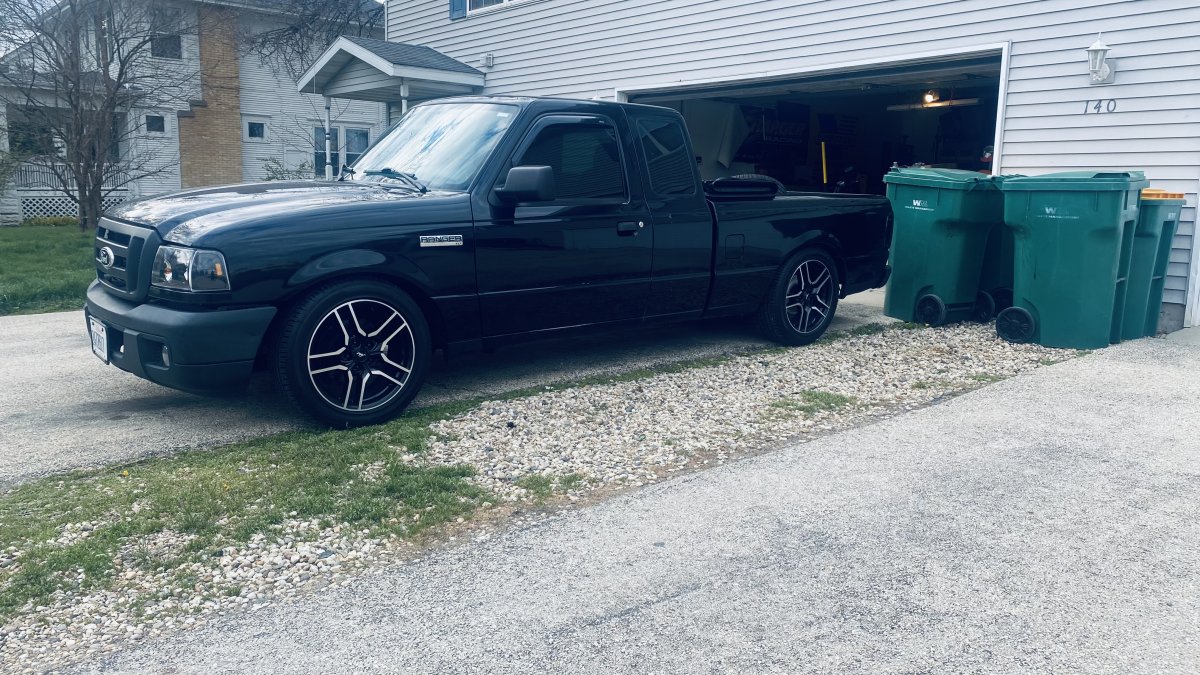

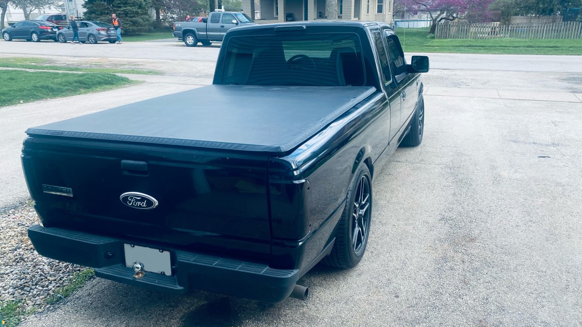

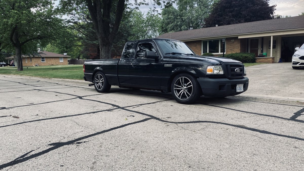

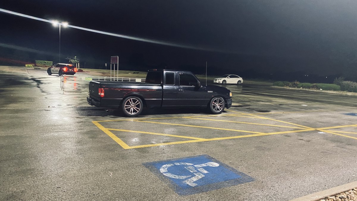

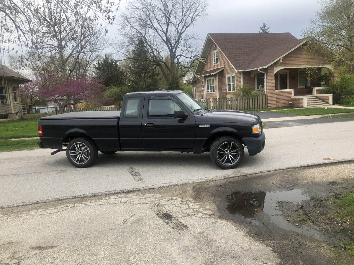

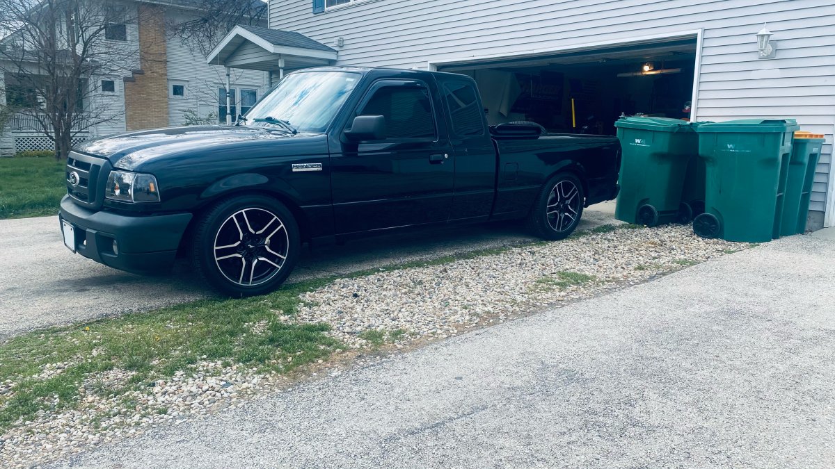

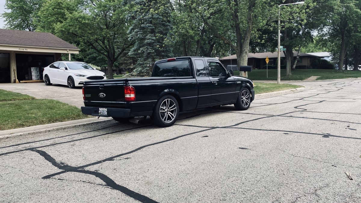

what size and make are those tires and rims? 3/4 drop kit?
2020 Mustang wheels, 18”. 235/50-18
3/5 Drop..with 5/8” Poly spring isolator.
With 1.5” Wheel Spacers.

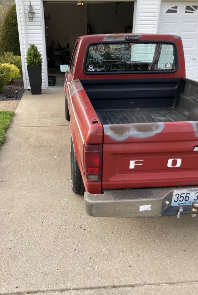

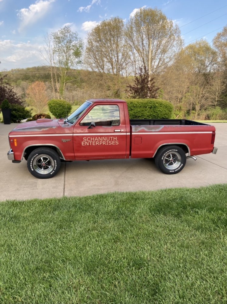

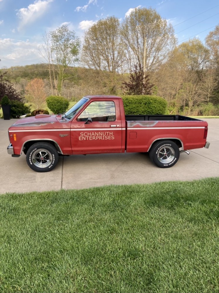

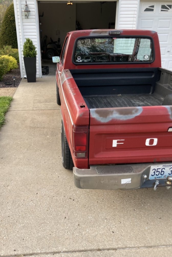

‘83 on stock suspension but it sits a little lower with the 5.0 up front and 150 lbs of steel under the bed for traction. I also added anti-rollbars to the front and rear. Still has a nice soft ride but it corners flat as can be.
255/60 15’s on 15x8’s in back with 235/60 15’s on 15x7’s up front.
I have a 98 2wd ford ranger and i have a set of track pack wheels off of my 2014 mustang the back fit fine could use some spacers to move the wheels out to fill the fenders out. But i cannot get the wheels to fit the front wont fit over the hub did you have to use the 1 1/2 spacers to get the front wheels to go on?

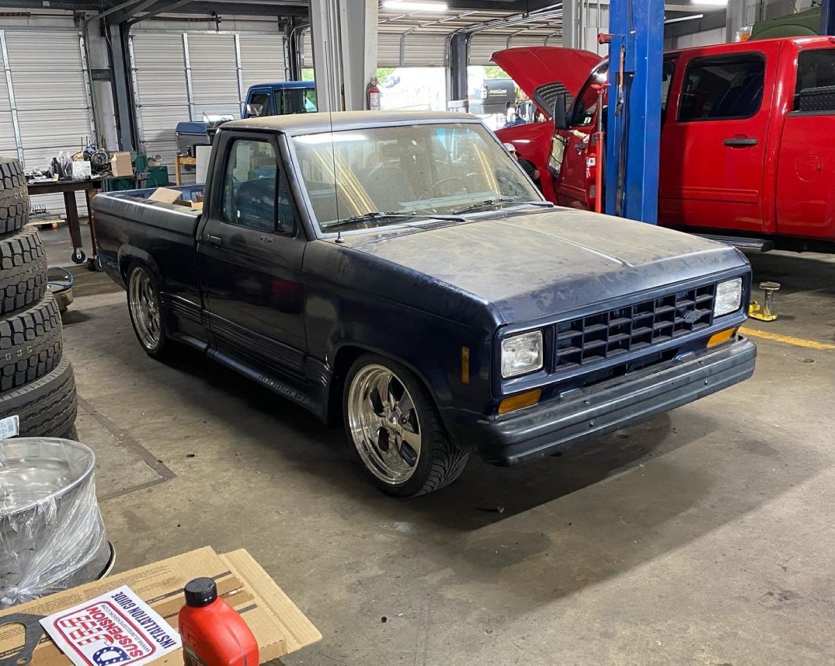

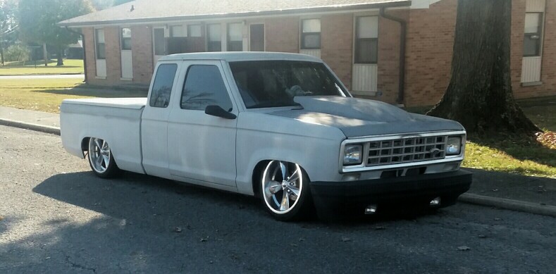

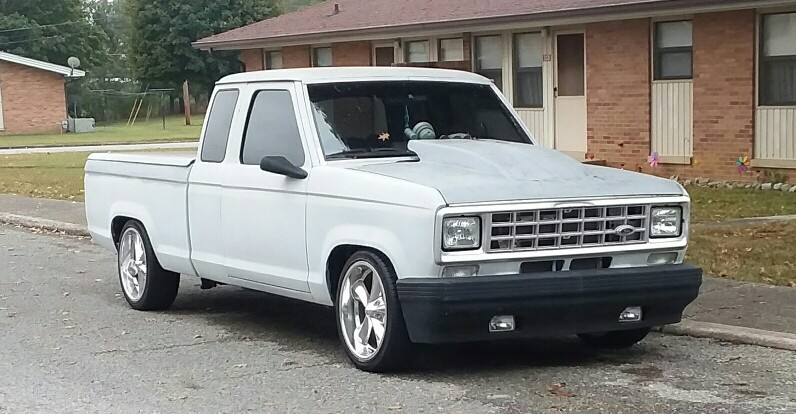

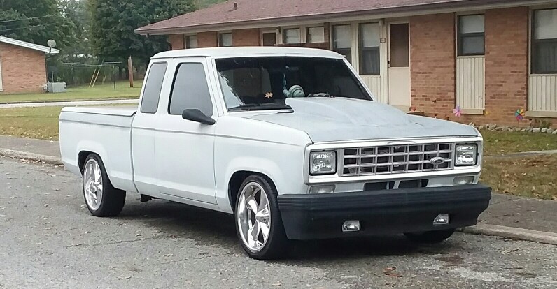

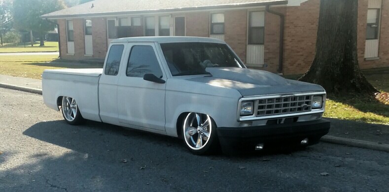

18" x 8" Boyd Coddington Junkyard Dogs w/4.5" backspacing & 225/40R18 Hercules "Ironman" tires.
I'm using Chassis Tech 3" drop beams on the front & Competition Engineering ladder bars on the rear. It also has Slam HE-6 bags on the front & Airlift 2600 bags on the rear. We set the suspension up to match the 3/5 drop, beam/rear flip kit I originally had on the truck at full ride height.
Dose the rears clear pretty good?

‘83 on stock suspension but it sits a little lower with the 5.0 up front and 150 lbs of steel under the bed for traction. I also added anti-rollbars to the front and rear. Still has a nice soft ride but it corners flat as can be.View attachment 59153View attachment 59154 255/60 15’s on 15x8’s in back with 235/60 15’s on 15x7’s up front.
I’m thinking about getting those for my ‘06.. I’m 2WD . I don’t know the offset.
Where did you get them?
David’s Rally Wheels on line.
