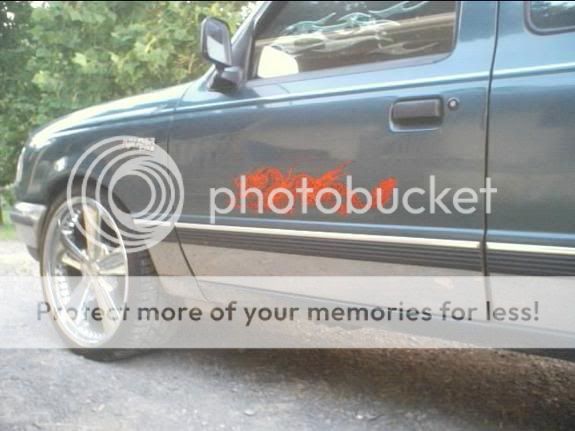

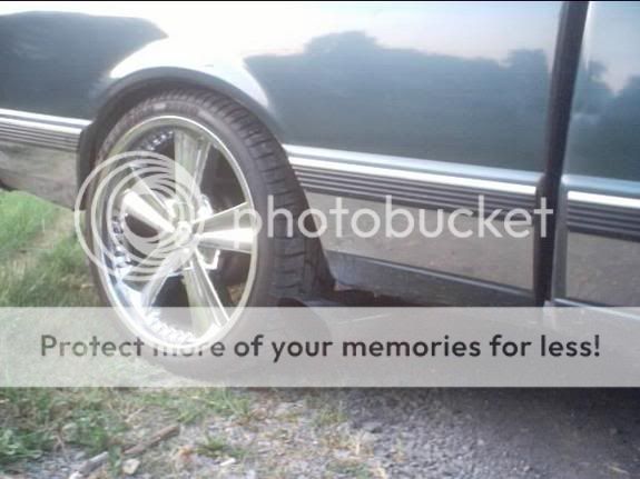

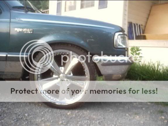

Okay, the first pics are of my 96 ranger dropped 3/5 3" beams up front, flip in the rear on 7.5 rear axle ( all stock components) on 22's..
