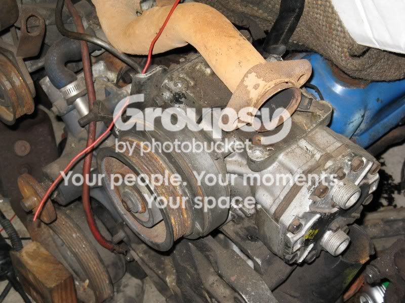

I've got a York 210 sitting here i plan on replacing my current Sanden compressor with, I just need to fab a bracket to mount the York to the 4.0L
JEALOUS!!!! Where did you find that bracket!?!?!?!?!! I must know.
It's on a junk 255 from a Fox body. Probably '80-82. Since I'd have to swap to the fox body accessory setup, I haven't put it in my rig yet.
I put a york 210 on a 2.9 which is pretty much useless to those running a 5 liter but I thought I would share. there is a place that you can get the serpentine belt clutches for about 70 bucks online too if anyone is interested i can dig the link up.
Ok, thanks for the info. Now I REALLY want the mustang accessories bracket package for the front of my 5.0L, raised power steering pump and room for a York! That would be bitchin'.

Again, thanks for the info, I AM interested in where I might find a serpentine clutch for a York, cause I think this winter I'm about to inherit a york, so that just puts me that much closer.

4.0Ls have a really easy way of mounting a compressor in the AC compressor location. Dishtowel, you could have my whole current drivetrain for cheap if you wanted to swap it into your BII in a years time....

I am building a bracket to mount the compressor under the hood right now, I spent 4 hours on the first one which I was completely disgusted with and scrapped. Wasn't a total loss thought, I havn't been in the shop for a while and I was just happy to have the torch/welder back in my hands.
