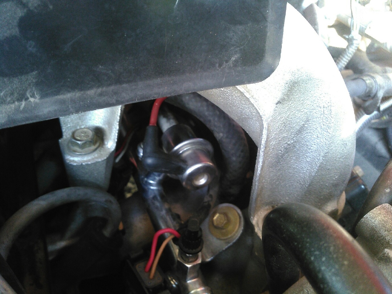

What next?? One idea is to have another smoke test. Another idea is the fuel pressure regulator, but I haven't been able to find one for this truck anywhere (not even parts geek has one, nor 1aauto or O'rielly). Also there is a tube coming out of the fuel pressure regulator (not the fuel line going in, but a thicker black tube in the back) that might be glued on? Not clear to me how it is connected or how I would get it off.

You already replaced the fuel pressure regulator. On a mechanical returnless system the three-port fuel filter is the pressure regulator. The smaller rear-facing port is a return to the tank, and there is a bypass valve that closes and diverts fuel back to the tank when the pressure in the forward part of the system reaches a certain point.
Hey adsm308, thanks for the response.
Are you sure? Yes, there is a 3-port fuel filter, but there is also this thing attached the fuel rail that looks (to me) like a fuel pressure regulator
Pesky P1131 on B2500
That does look like a vacuum pressure regulator. It would help to know where that other larger line off it goes.
I know that is how it works on the later ones.
Did you test fuel pressure? If the pump is dying it might not be giving enough pressure to supply the necessary fuel.
