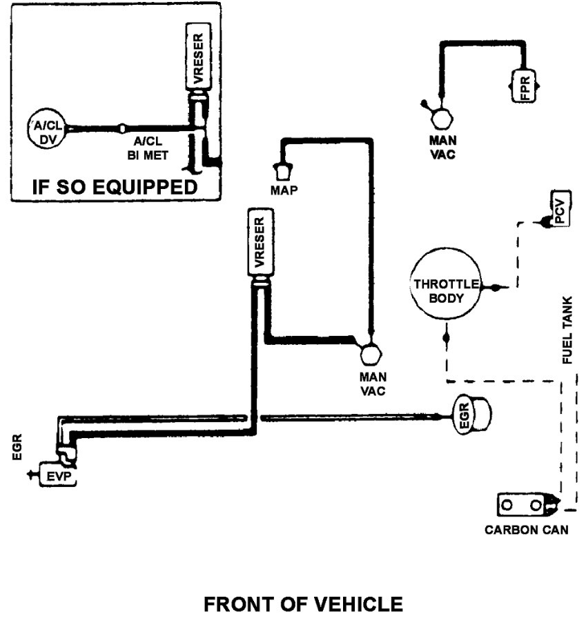

(Vacuum routing for vehicle)

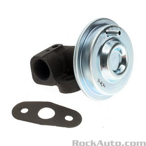

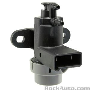

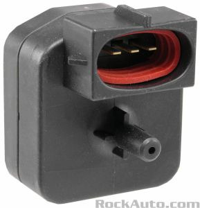

1. EGR Valve 2.EGR Vacuum Regulator (EVR) Solenoid 3. EVP Sensor
  • I identified the EVR porting: bottom port = vacuum source from the EGR tube/manifold vacuum side, and top port = EGR valve side.
  • I measured about 20 mmHg at the tube feeding the bottom port of the EVR while the engine was running, which supports that the vacuum source is present.
  • The EVR coil resistance checked around 50 ohms, which suggests the electrical coil is not open.
  • I measured that the EVP sensor is getting 5V, ground is solid, and the sensor wire is giving off ~3.18V
  • When I compared it with a new EVP, it gave the same reading.

EGR valve moves freely; it's a new EGR.
Does it actuate as it should under vacuum? With the crap shoot that new parts are these days, it is entirely possible you did everything right but a bad new part is keeping you down. A good number of us have been stung by bad new parts.

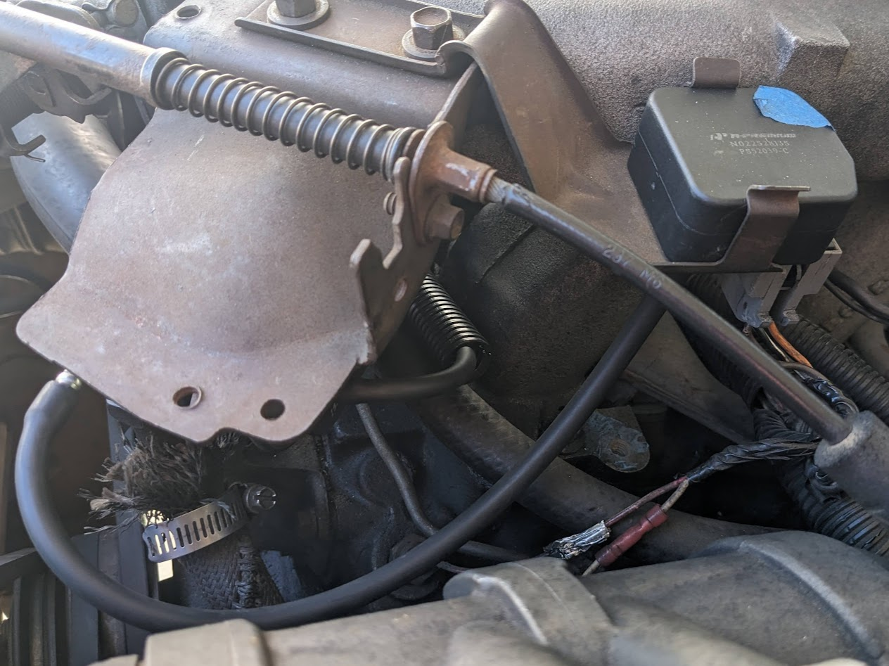

Did you also replace the pulse sensor? (Little black box clipped in right above EGR with a tube running to it)? If thats shot or the wiring is bad the ECM wont know whats going on.

I believe the "Black Box" you're referring to is the EVP Sensor.

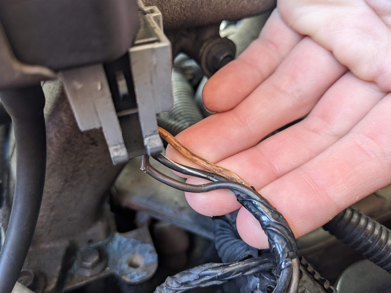

I took measurements from all 3 wires
Persistent Code 84. (1987 Ford Bronco II Auto)
Orange is 5V
Black/White is Ground
Brown is the Signal; From this, I'm getting 3.18v on Key On Engine Off
The Code 84 makes me think it's the EVR (Solenoid).
From my understanding, the EVR gets 12v, the computer pulses the ground connection, which in turn causes the vacuum to pulse. When I connected an LED to the back of the ground connection and to the chassis, the LED did not pulse, which leads me to believe either the EVR is still bad (3rd one) or the computer is not able to create the pulses.

That brown signal wire looks suspect, i know the broken insulation isnt much...but being so low voltage it wouldnt take much corrosion to throw the signal to the ECM off.
That is how the vacuum solenoid works. When i tested mine i just stuck a black wire in the ground side, and turned the key on and touched the black wire i inserted to the negative battery terminal. Youll hear it click if its good.
Also, the top pops off the solenoid, theres a little filter in there, its rare but the filter can become plugged.
If the solenoid clicka when you ground it its likely the wire between it and the ECM or the ECM itself.

I agree, I would take a good hard look at that brown wire. You might have to pull the terminal out of the plug and replace it to properly fix the possible break and/or corrosion. I've had to deal with a few of those on the Post Office delivery trucks lately.

Sadly, that brown wire damage is from me; it's from me probing it with a needle. The wire itself is good; the insulation is just protruding in that shot.
