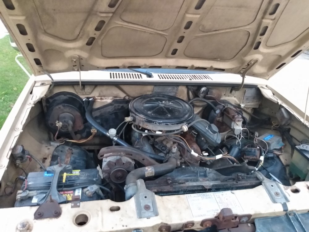

Papaw's BII
I bought a new full size spare over the weekend and got a cover for it.
Looks just like the one that was on it for years before it blew off going down the road years ago.

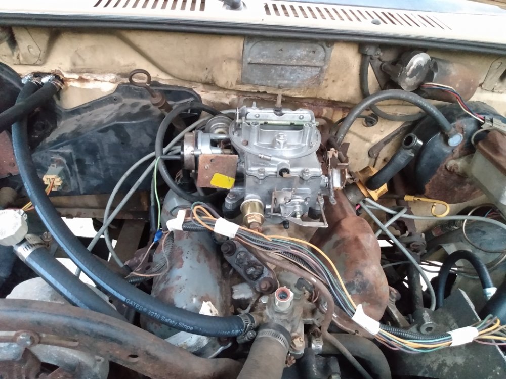

I did the duraspark conversion on my '84 this summer and rebuilt the carb as well. That was a week of fun - following guides and searching through old posts. Anyways, I only recently got the choke set right.

View attachment 32694View attachment 32695

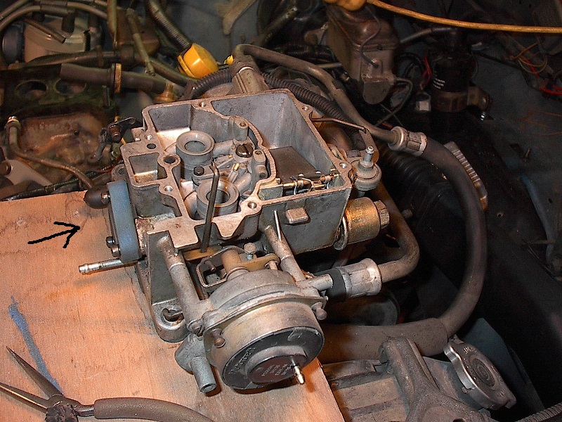

I used the original 2150A that came on the truck, replacing the solenoid with a manual adjustment block; see the pic. The instructions for this used to here on TRS, somewhere.

Here's the carb mod:

As for the carb, is the metering or manual block, does it just control the amount of air going into the back of the carb? How do you make adjustments?

Yes, the manual metering block just controls the air in place of the solenoid. There's a passage carved into the carb side of the block, with an adjustment screw sticking out it which unfortunately you can't see in the picture.
Bingo! You found where I got the idea from. It worked good on mine.
