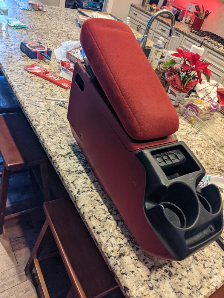

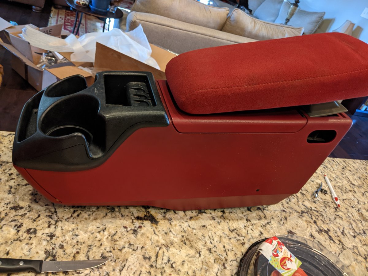

Picked up a console from a first gen explorer for my B2. Its in pretty good shape. I probably over paid for, but it is hard to find them in good shape. My new seats I have don't have an arm rest, but this should help a lot with cup holders too!

That's a nice console. I have the same one in my Ranger and love it.
I'm more excited about the cup holders than anything. Lol first world problems.
Spoke to the trans shop, they said a valve was sticking open in the valve body. They are warrantying a rebuilt one that is supposedly FOMOCO rebuilt or something along those lines. They are putting the new valve body on and a new modulator and going to check it all again. They are waiting on the valve body to come in. I think it will be ready by the end of this week. I hope, I already miss driving that thing.
Cool console. Did you get the mounting bracket that goes underneath it?
FYI there are three different cup holder variations - the one you have now, one with a single cup spot, and another one with two cup holders but in a row parallel with the seats. That one is usually found in 94-up trucks, mine came out of a 94 B4000. The cup holders are deeper and I don't have shifter problems with big cups anymore - the single cup one is awful, the one you have is just a marginal improvement.
Yes, I have the bracket and all the screws with it. The seller actually turned out to be a pretty good one and sent all the hardware.
I had seen where you can replace the cup holder inserts. The one in it now seems like it will work ok, it is a vast improvement over not having any at all!
