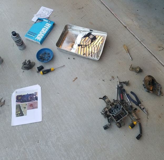

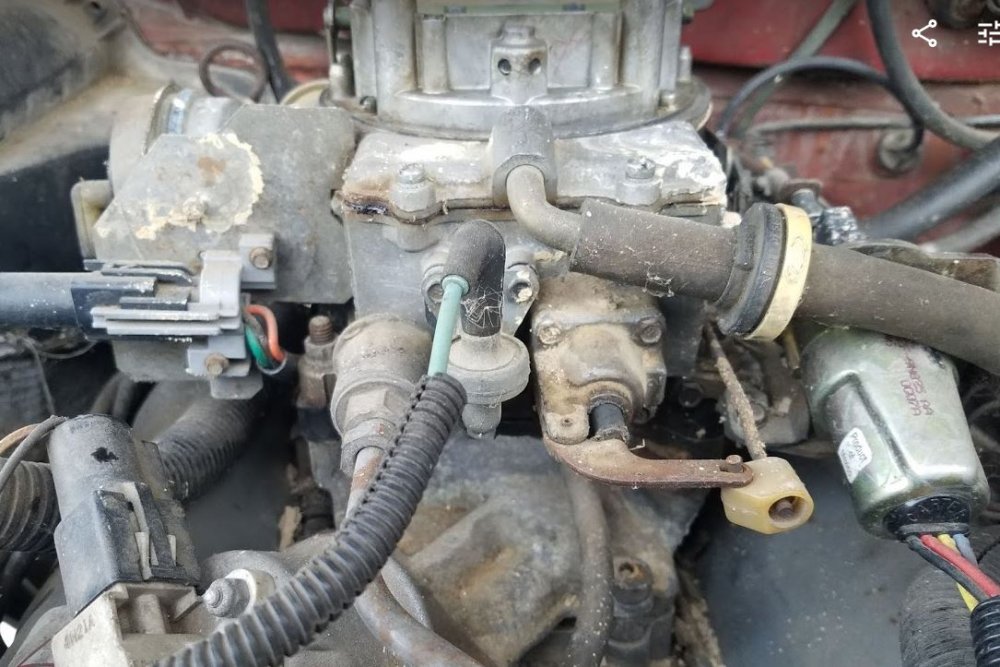

I ordered a carb rebuild kit and a new coil pack that should arrive today.
I am also going to replace the starter solenoid. The one on it has 4 terminals I believe. It doesn't seem to want to crank right.
The local O'reilly has a Motorcraft one that I'll probably pick up.
Starting to look over the carb to disassemble tonight.

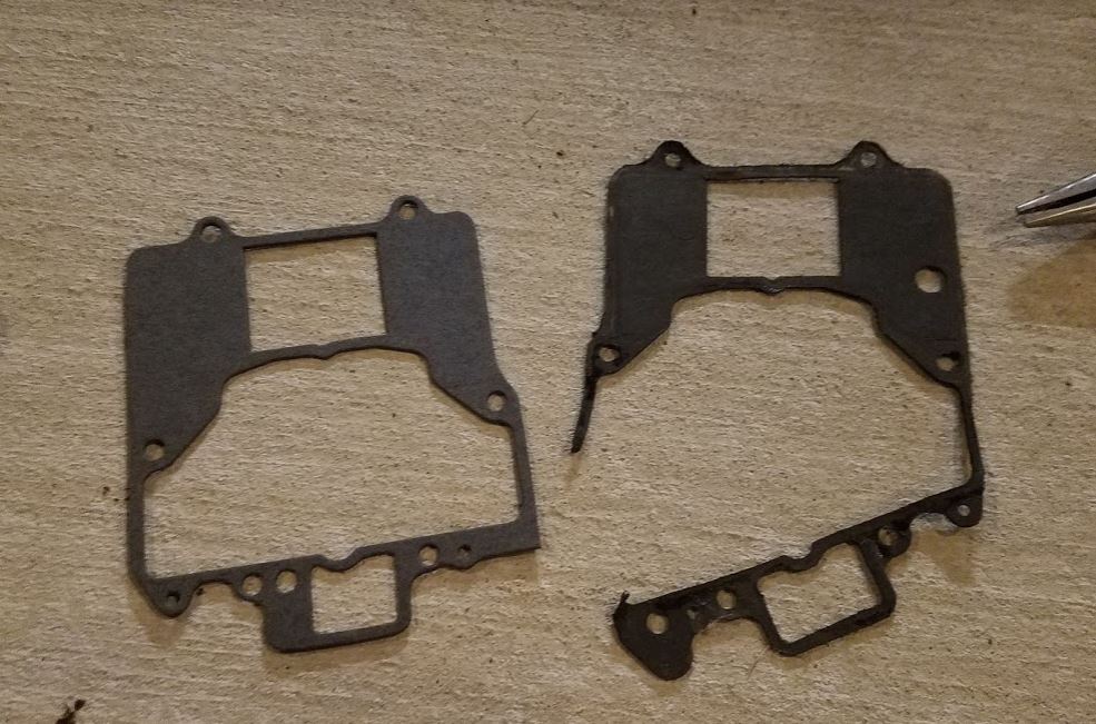

I made a little more progress last night.
I got my carb rebuild kit and got it off and cleaned up.
It appears someone either disassembled or tried to rebuild it before me.... They weren't very successful.
I found the top gasket to be broken, could explain why it could have had a fuel leak at one time from the carb.
I also put the new coil on last night too. The trick today will see if I can get it to run.

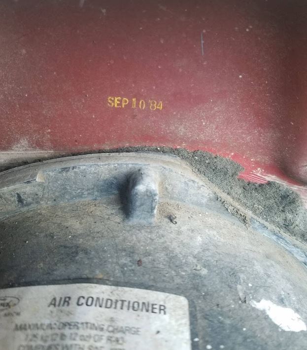

On another note, was looking under the hood and found a date stamp on the firewall.... I assume this is when it was made. Thought it was pretty cool it has survived over 30 years....
