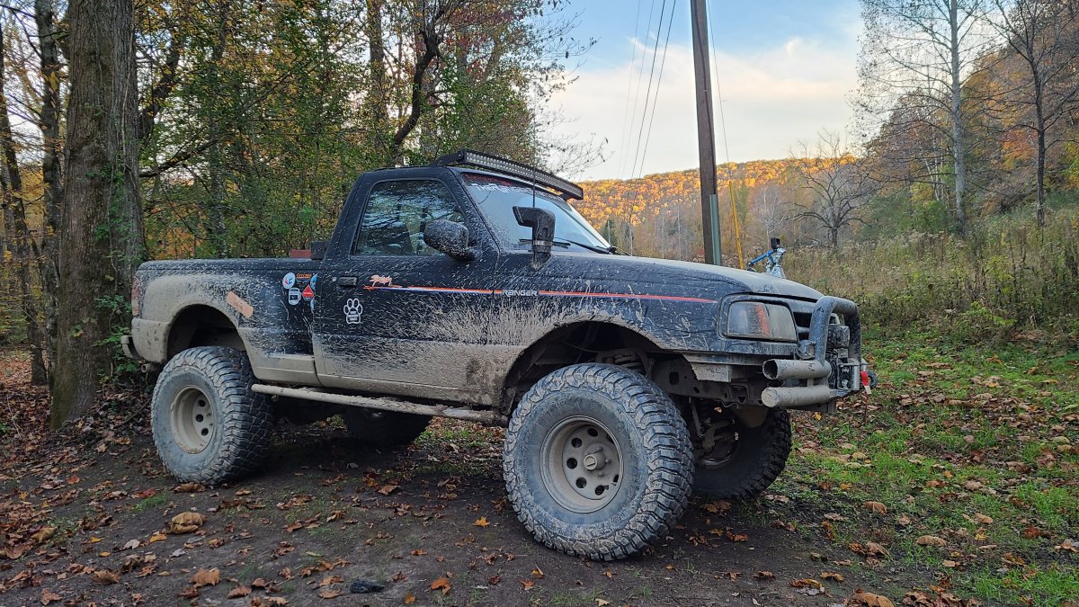

When I do my sub-par job of painting(every run and mistake is my signature) my truck I put 2-3 coats on it. The Ranger didn't need clear coat, but the Tacoma did and it's a little on the heavy side.
