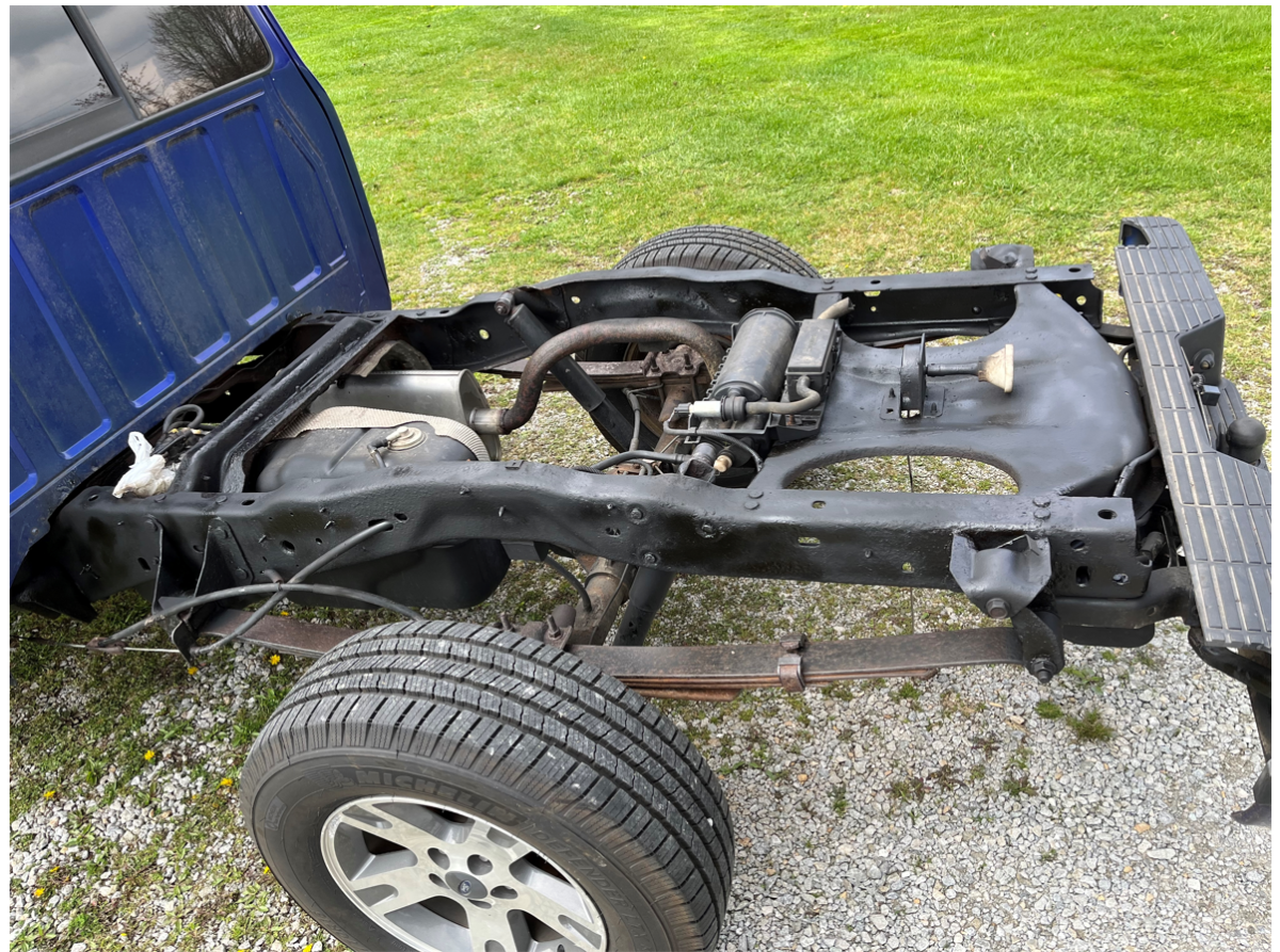

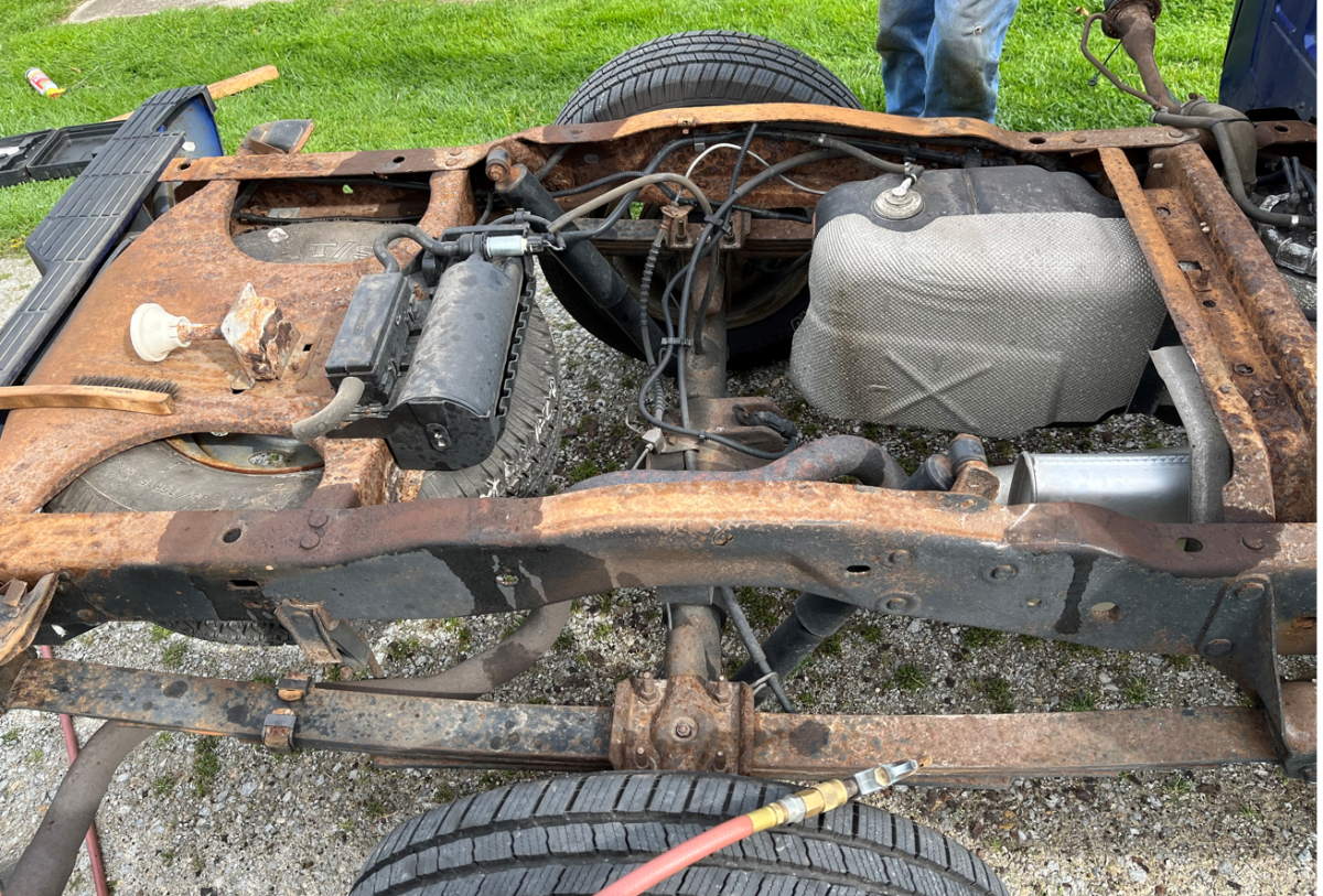

I just added a few years on to my Ranger. I did this in 1 weekend.
Well done! I used Synmast on my last truck. It stopped the rust dead in its tracks. And being epoxy, it set up rock hard, perhaps even as hard as powder coating, making it perfect for the frame. Synmast was originally made to strengthen fiberglass and replace toxic polyester resins. You can buy synmast here: https://www.polygem.com/

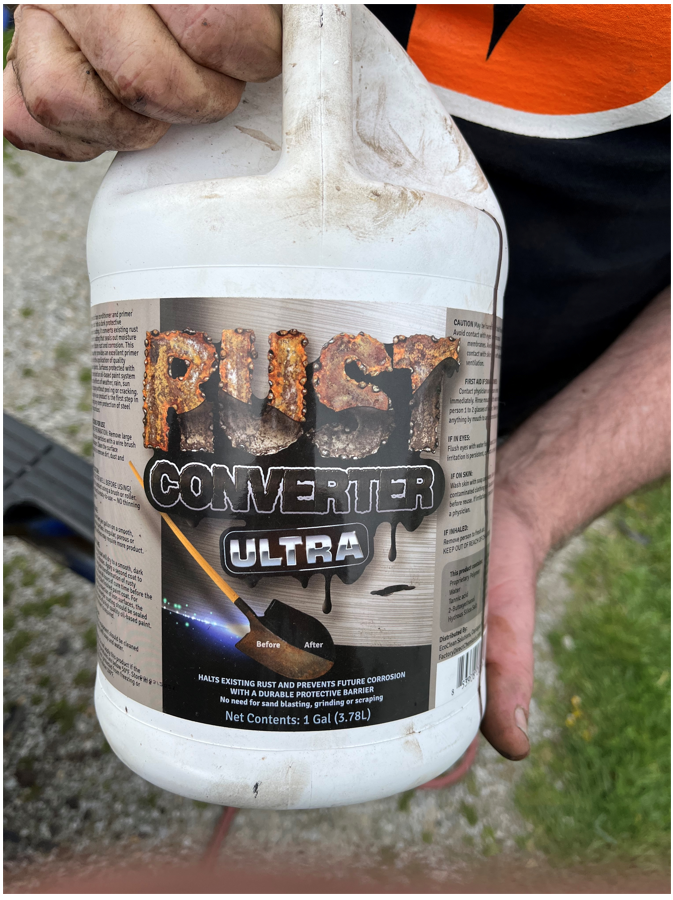

It will also adhere to paint without dissolving it. Judging from the fotos, it seems as though you first applied a coat of rust converter?
