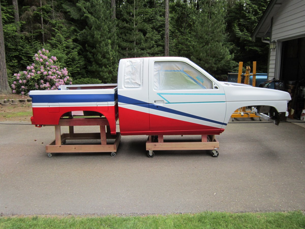

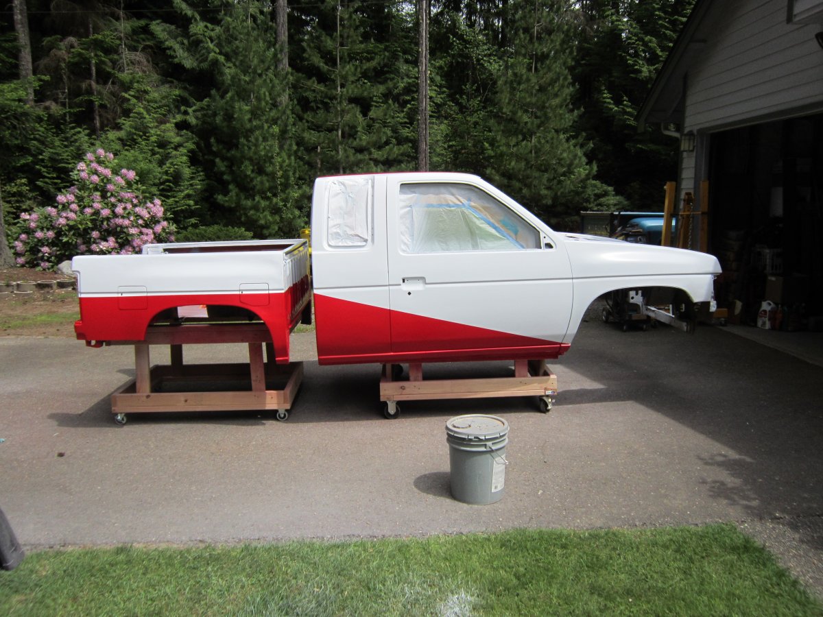

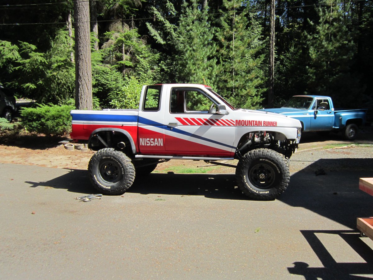

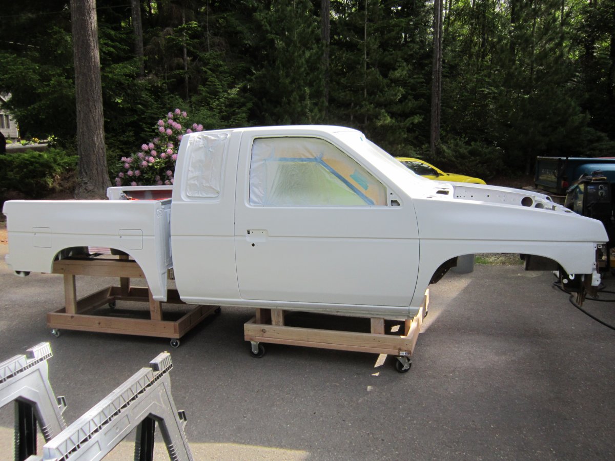

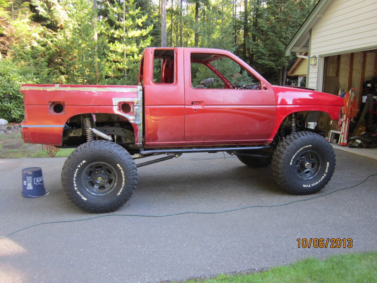

Do it yourself. It takes time for sure but as long as you don't rush things it will come out nice. Mine took a couple of months with bodywork and paint. $700 in paint and supplies.

2 gnats gave their life for the clear coat and 1 run on the front corner above the turn signal.
Jesus Murphy that looks like about a million hours of work...but if you have the, skill, space, and time....sweet
Actually, the paint was done over 3 or 4 weekends, each Saturday about 3-4 hours, masking/taping off is the hard part. Spraying was the easiest part. The sun did the baking for me.
Body work that is another story, I think it took 5/6 months, 3/4 weekends each. Probably 5/6 hours each day. The truck is certainly not perfect, but I'm very satisfied with it.
