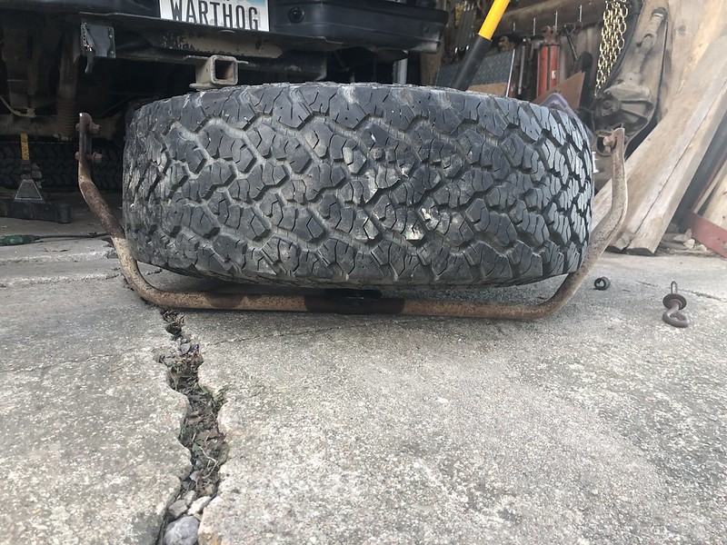

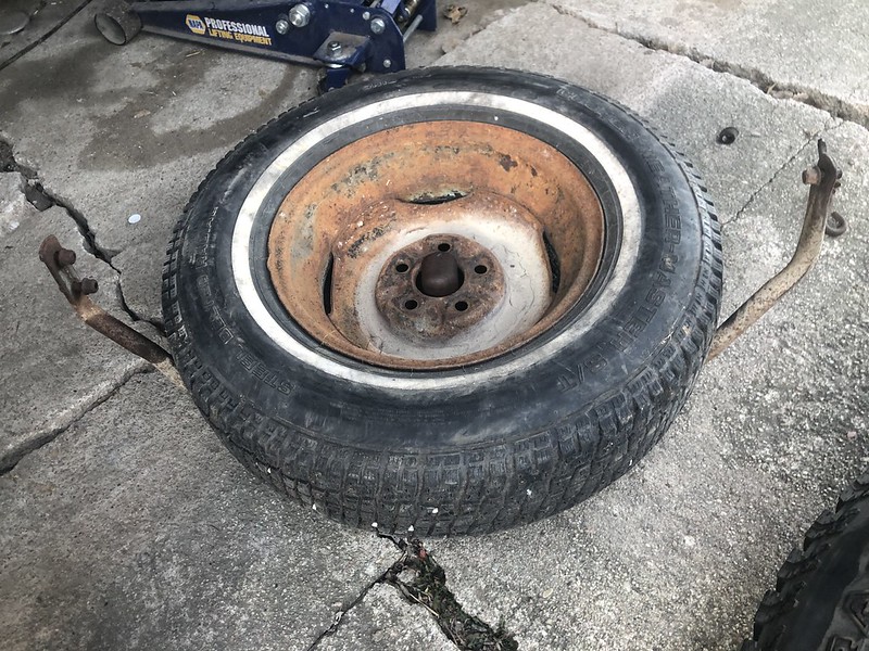

After a fight I got the eye bolt out:
31 is a no-go.
The center hub part is nowhere near the rim, the eyebolt won't reach anything.
Shown with a smaller tire:
If I made a different hoop that didn't tuck in so much...
