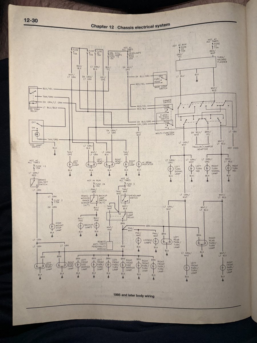

I see a dimmer switch here but have no idea how to read this mess, could someone decipher this for me and maybe point me where to look? This is from Haynes by the way. Thanks!
Sorry, man; wrong diagram. That "dimmer switch" is for the head lights.
How is there a dimmer switch for the headlights?
Reading the diagram, the dimmer switch on that page powers two headlight filaments and powers the fog light relay coil when it's in the "low" position.
Confusing terminology- it "dim"s the fog lights when the head lights are on high beams, even though it's also powering the head light low beams. So it's more like "low beam head light AND fog light switch power".
It takes some practice, but reading a wiring schematic is a lot like reading a map.
I agree, that is the wrong schematic. Look at all the lights in the diagram and the multifunction switch. The dome light is no where in there.

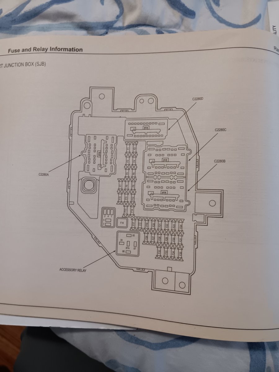

Smart Junction Box and what fuse does what. It looks like fuse F13 is the one we are interested in. Confirm with the listing and diagram in your Owner's Manual.

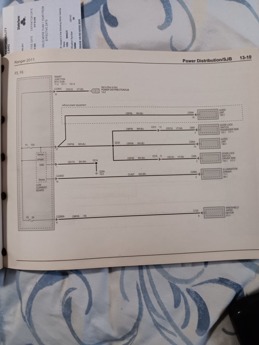

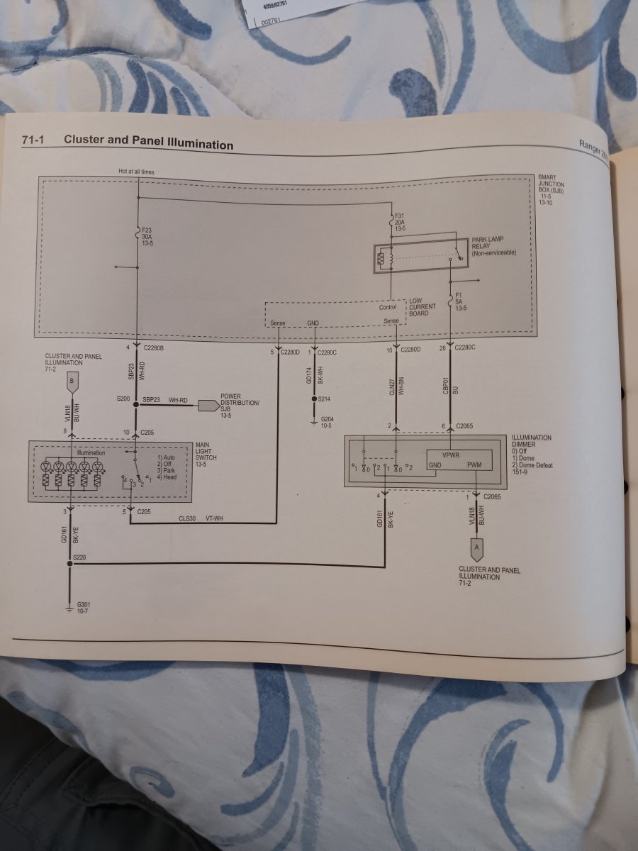

Here is the power distibution diagram. Look for illumination dimmer.
Cluster and illumination diagram. Illumination dimmer is on the lower right.

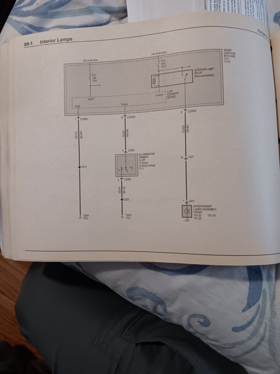

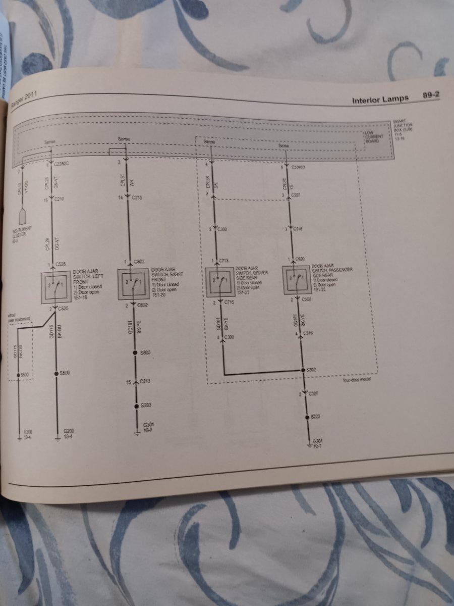

Interior Lamps diagrams.
The wire colors may be wrong for your year, so keep that in mind. The circuit layout should be the same or atleast close enough to troubleshoot.

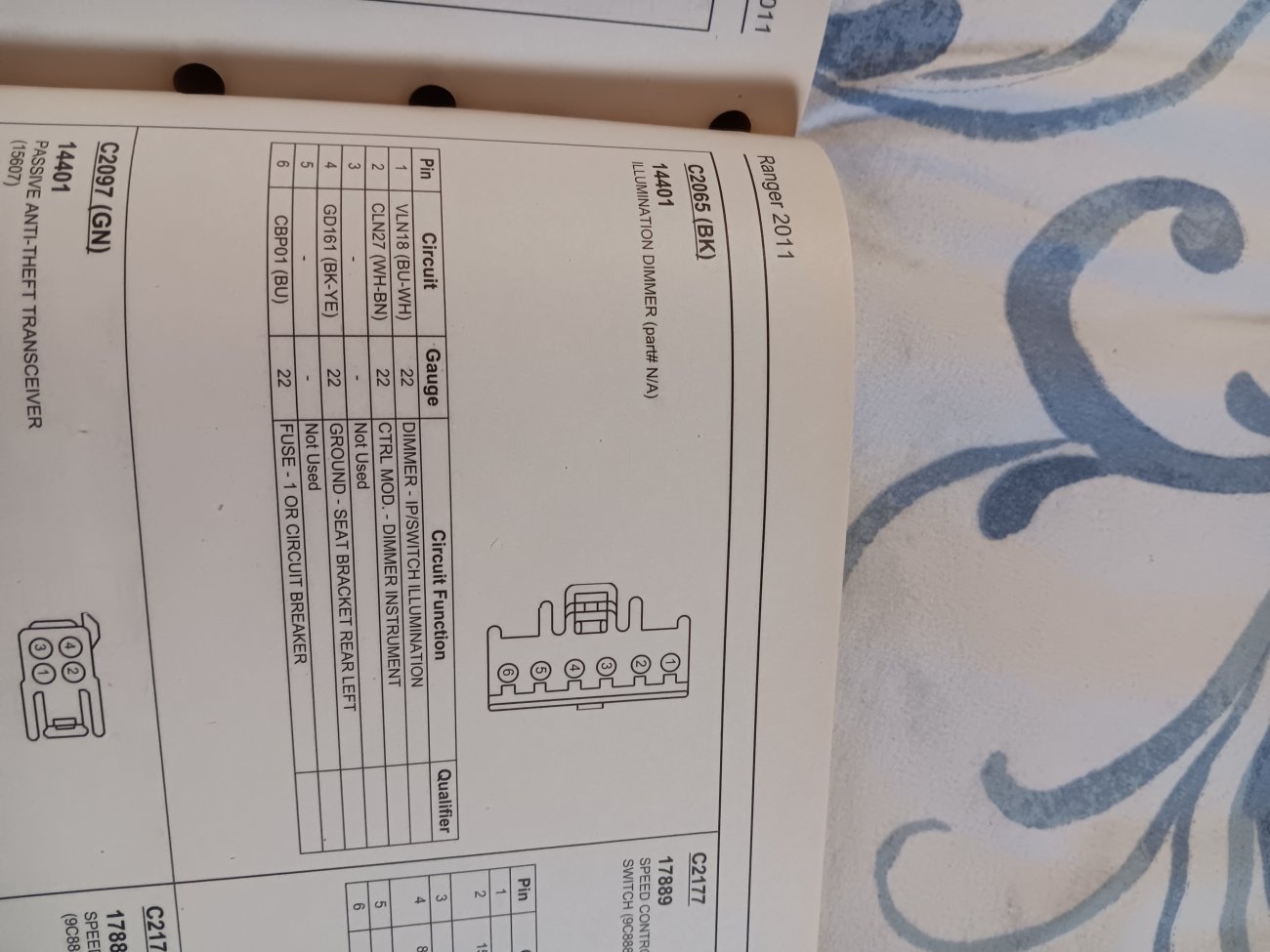

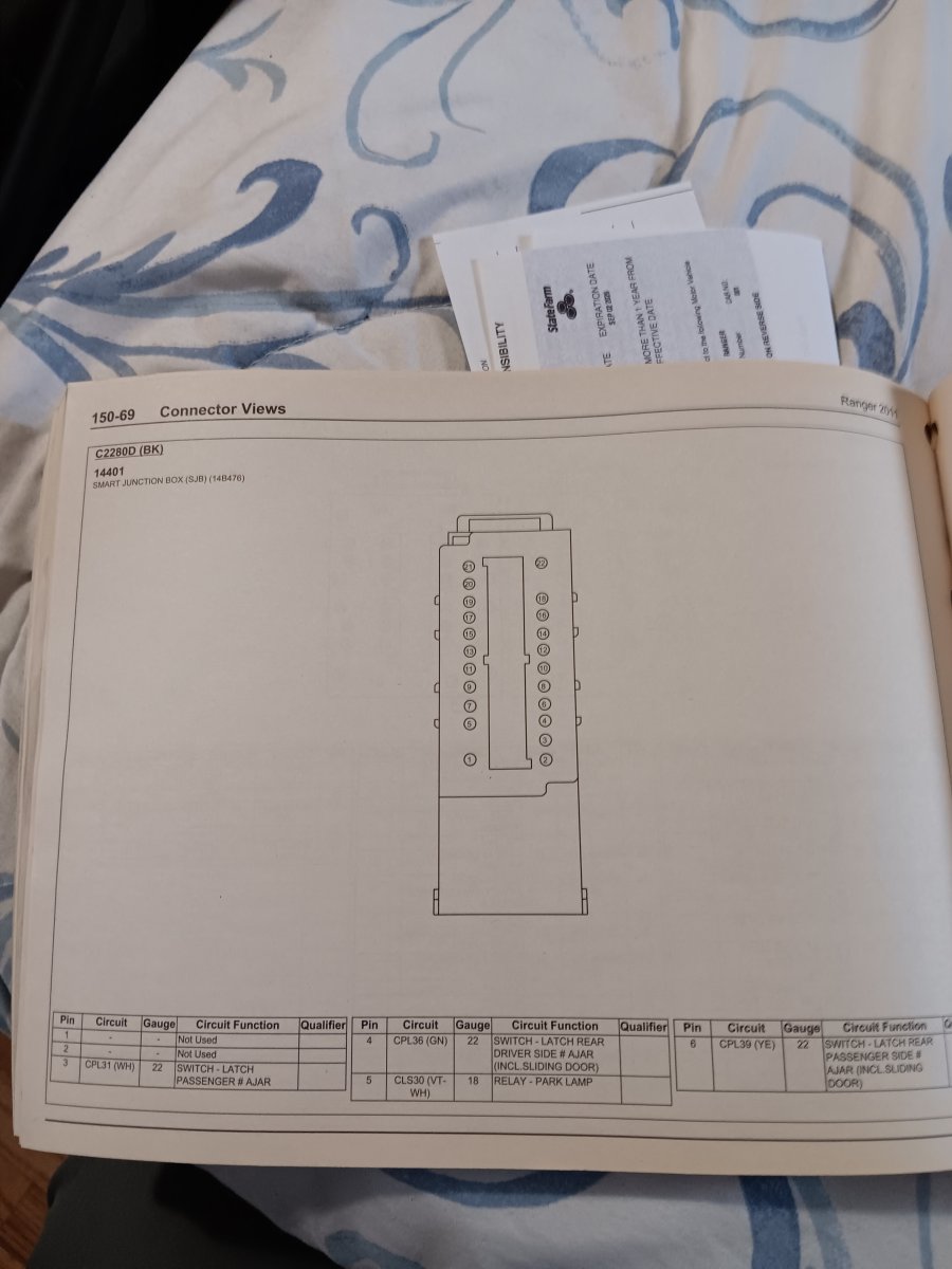

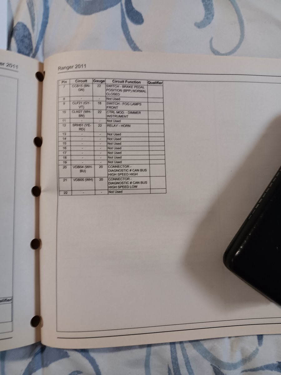

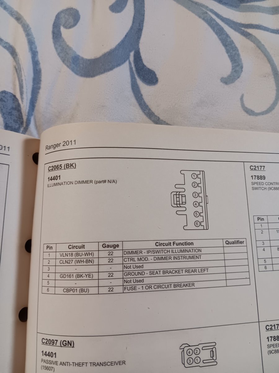

Here is the pin layouts for the connectors in question.
C2065 - at the switch
Overhead Light Switch Not Working
C2280D - at the SJB

Maybe this is a dumb question but I don’t really know what to do with those diagrams, like how can I tell where the wiring goes? If I were to guess, it looks like the dimmer goes directly to the SJB, is that correct? If so, should I just probe the SJB for voltage at C2065 and C2280D? Thanks for all the help!
You can look for power at the connector for the dimmer switch and at the connector at the SJB.
You can also check for wire continuity at both connections to make sure the wire or a terminal is properly connected.
It wouldn't be a horrible idea to visually inspect the wires to see if any of them may have had the insulation worn off feom vibration or got damaged some how. You can follow the wires back from the dimmer to the SJB. Though, working under the dash is rarely fun or comfortable.
I’ll probably just check for continuity because those wires run way behind the dash and I’d have to pull everything off to get back there and j really don’t want to do that😂
My Illumination dimmer is only 4 wire, well shoot
